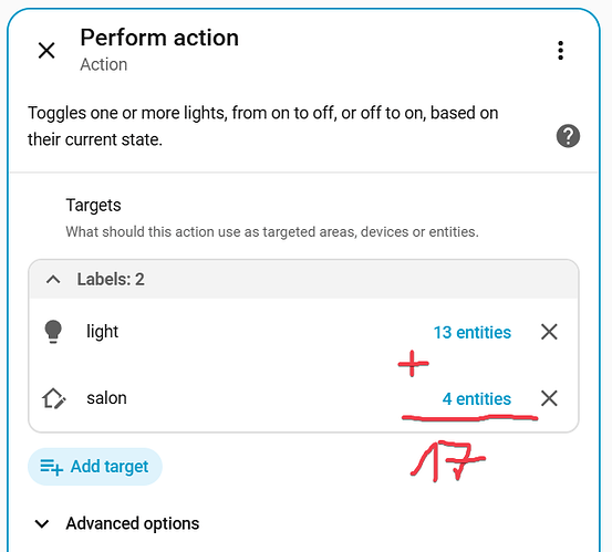

I am considering switching to labels to select automation targets. To set the context, lets say that I have, for a given entity
  • a “room” label living room
  • a “type” label light
I have many rooms, each with their label, and I have entities, including many that have the “type” label set to light.
I want to target all lights in the living room.
Unfortunately, what I get from building an automation and choosing these two labels is:
action: light.toggle
metadata: {}
data: {}
  label_id:
    - light
    - salon
The labels are connected with an OR. How can I connect them with an AND?
