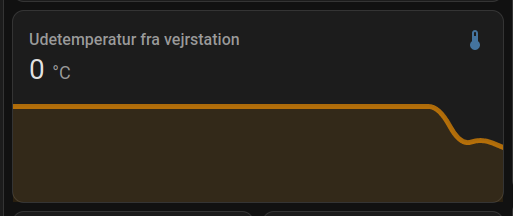

Not receiving a value seems to not trigger a zero - this is the history graph for this entity:
No zeros there - just time intervals with no reading. But in the “Sensor” card, it looks like this:
billede
Which is funny, since no zero was ever sent.
How can I make this card just display the last received value if it doesn’t have an up-to-date one?
