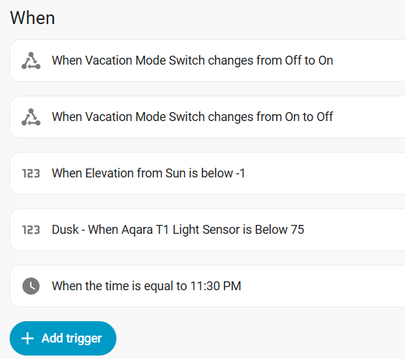

I used this automation while away on vacation and it worked as expected. I have a "Vacation Mode Switch" toggle that when I turn it on certain actions are performed. Then I also have other triggers which look at the sun's elevation, a light sensor value, and also the time of 11:30 PM.
My concern is if I leave the automation enabled after returning from vacation, the triggers will still be actively listening for these events but performing no action, since I have the condition "If vacation mode switch is on", so if switched off, no actions will be executed.
Should I simply disable this automation when I'm not on vacation? Or is there a better way to write it so the triggers are not still waiting for an event?

  - alias: Dusk - When Aqara T1 Light Sensor is Below 75
    entity_id: sensor.aqara_t1_light_sensor
    below: 75
    trigger: numeric_state
  - trigger: time
    at: "23:30:00"

There are varying opinions on this kind of thing. Personally, I just leave them and reserve the option to disable and enable automations for emergencies and maintenance. That would include, especially, not using the automation.turn_on and automation.turn_off action like you are using.
A couple extraneous triggers a day is not worth worrying about.

I would tackle this very differently.
Firstly, I'd split the vacation on and off parts.
I would also get rid of the self-referential triggering, where changing the vacation mode will trigger the automation again. In future (with more changes), this can cause trouble and I think it makes debugging harder.
By separating the automations, you can then move the conditions you have under choose into the main condition blocks. You can also get rid of the trigger IDs.
It's also generally better to control automations via conditions and helpers, rather than turning automations on and off. It's not that it's wrong, because clearly it's allowed. It's more of a best practice.
I know you might like having a single automation, but you asked for feedback. :slight_smile: Up to you!
Thank you I will look into your suggestions. I was also thinking that having a separate automation which switches the helper Vacation Mode Switch off or on, I could disable AND enable the automation if I wanted which would eliminate the active triggers. But as Didgeridrew stated a couple of extraneous triggers a day is not worth worrying about.
