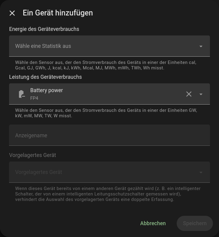

I can then also select it in the energy dashboard:
However, this is only a power sensor (in W) apparently, not an energy sensor.
