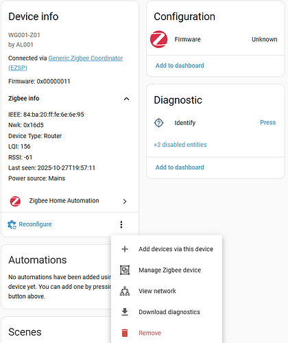

Gonna paste what I wrote yesterday when I replied to a similar question:
“Older Aqara devices (using Zigbee 1.2 instead of Zigbee 3.0) were known to be hard headed and would try to maintain a connection to the first device you paired them to. Remove them from the network, find the closest zigbee device for each one, then click “add devices via this device” in the router device page. That should sort out your issue.”

but i had try this before and i could not add device to zigbee through the router (extender). The client within a range of 10cm at the extender. or should it always be nearby the coordinator ? using Add devices via this device
Paring with the extender is an issue actually
Normally i pair close to the coordinator. And that works normally within 30sec
I now was pairing close to the router(extender), and that did took more time
I needed more then 1 min than it paired
After that i waited 5min to see the visualisation. And it worked

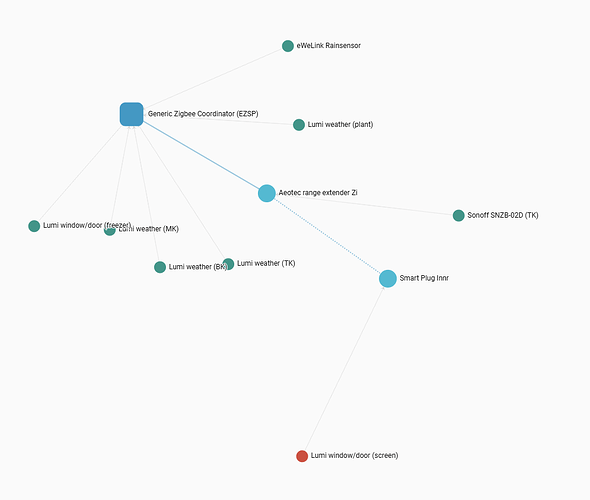

But strange thing is
Client is connected to a different router
I placed the client directly on the aerotec extender Zi, but is it connected to a inner smartplug which is 5meter away
mmhh client is after some hours offline
