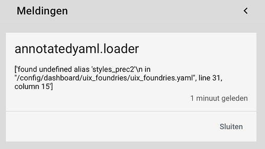

so that would be enough to set the automation trigger, and create a useful notification…
unfortunately those are not in the 1 single event, so my challenge lies in combining this
ok this works, and is rather easy and straightforward.
automation:
  - id: alert_yaml_error
    max_exceeded: silent
    triggers:
      trigger: event
      event_type: system_log_event
      event_data:
    actions:
      - variables:
          message: >
            {{trigger.event.data.message}}
      - action: persistent_notification.create
          title: '{{trigger.event.data.name}}'
          message: '{{message}}'

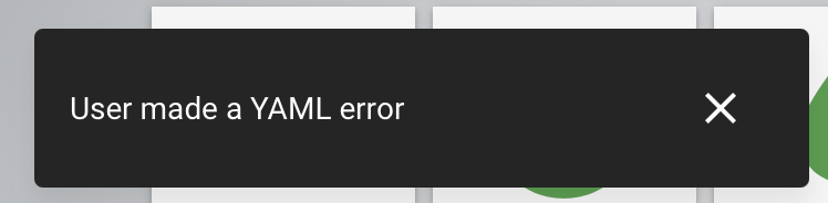

so even while the Yaml checker on /developer-tools/yaml doesnt check this syntax for custom integrations, the automation catches it because of the system log event.
next step: create a toast :wink:
document.querySelector("home-assistant").dispatchEvent(new CustomEvent("hass-notification", { detail: { message: "User made a YAML error", duration: -1, dismissable: true }, bubbles: true, composed: true }));
ok settling for this
automation:
    triggers:
      trigger: event
      event_data:
    actions:
      - variables:
          message: >
          title: '{{name}}'
      - action: browser_mod.javascript
          code: |
                detail: {
                  message: "{{ (name ~ ': ' ~ message) | replace('"', '\\"') }}",
                  duration: -1,
                  dismissable: true
                bubbles: true,
                composed: true
and styling in theme for that particular toast dialog

  uix-toast-yaml: |
      {% if "UIX has been updated" in params.message %}
      ha-button {
        --wa-color-on-normal: green;
      {% endif %}
        div.toast {
          background: var(--alert-color);
          color: white;
          animation: blink ease 2s infinite;
          box-shadow: var(--box-shadow);
          border: 3px white double;
      {% elif "annotatedyaml.loader" in params.message %}
        div.toast {
          background: var(--warning-color);
          color: black;
          border: 3px var(--success-color) double;
      {% endif %}
      @keyframes blink {
        50% {opacity: 0.4;}
      @keyframes glow {
        0% {
          box-shadow: 0 0 0px var(--warning-color);
        50% {
          box-shadow: 0 0 4px 2px var(--success-color);
        100% {
