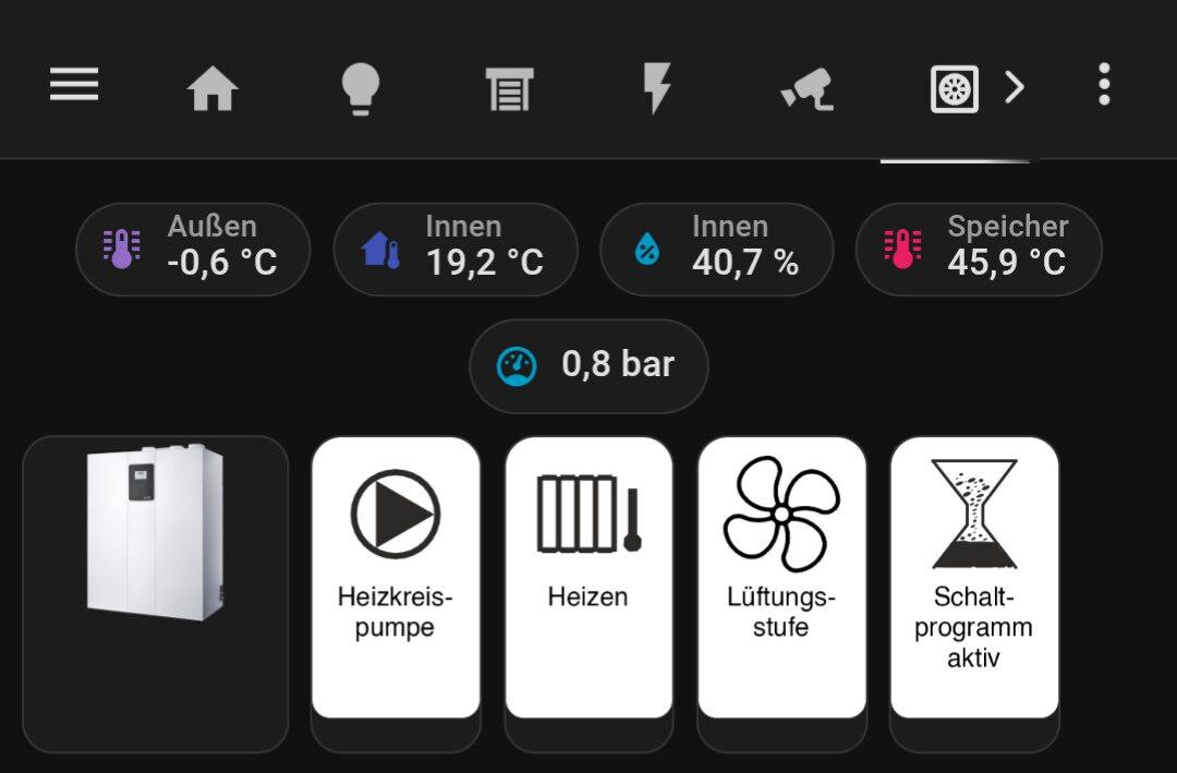

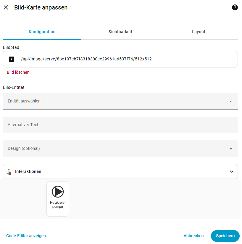

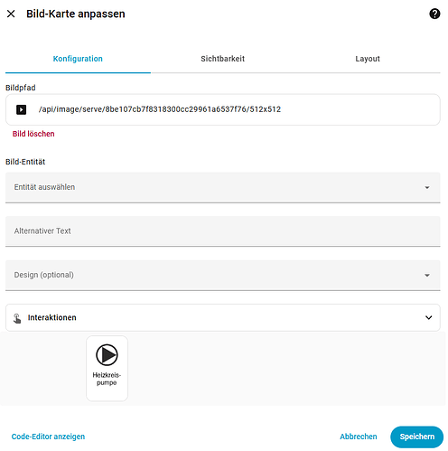

I have several pictures of my heating pump which are shown on my dahsboard related to the device status.
On computer or mobile, the card gets different ratios depending on resolution and window given space.
That leads to the point that the ratio of the card gets different but the picture inside is alwas shown top centered.
Tired couple of YAML configuraitons with Gemini, CGPT or Deepseek but none of their YAML configurations worked.
What I want it to look like is a total centered alignment, do you have any ideas on that?

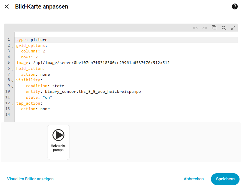

type: picture
grid_options:
  columns: 2
  rows: 2
image: /api/image/serve/8be107cb7f8318300cc29961a6537f76/512x512
hold_action:
  action: none
visibility:
  - condition: state
    entity: binary_sensor.thz_5_5_eco_heizkreispumpe
    state: "on"
tap_action:
  action: none
Configuration on the Dashboard
Dashboard Card YAML
Look and alignment when ratio changes, top centered
Look on my mobile with also another ratio, top centred

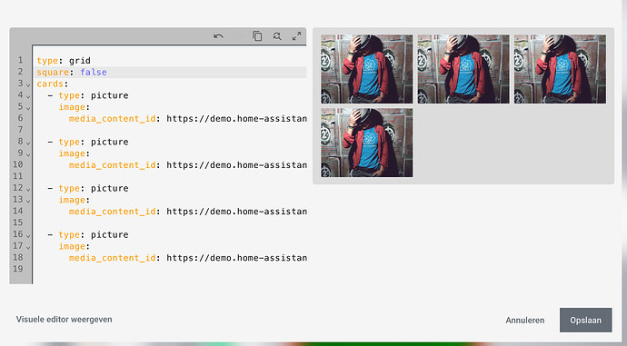

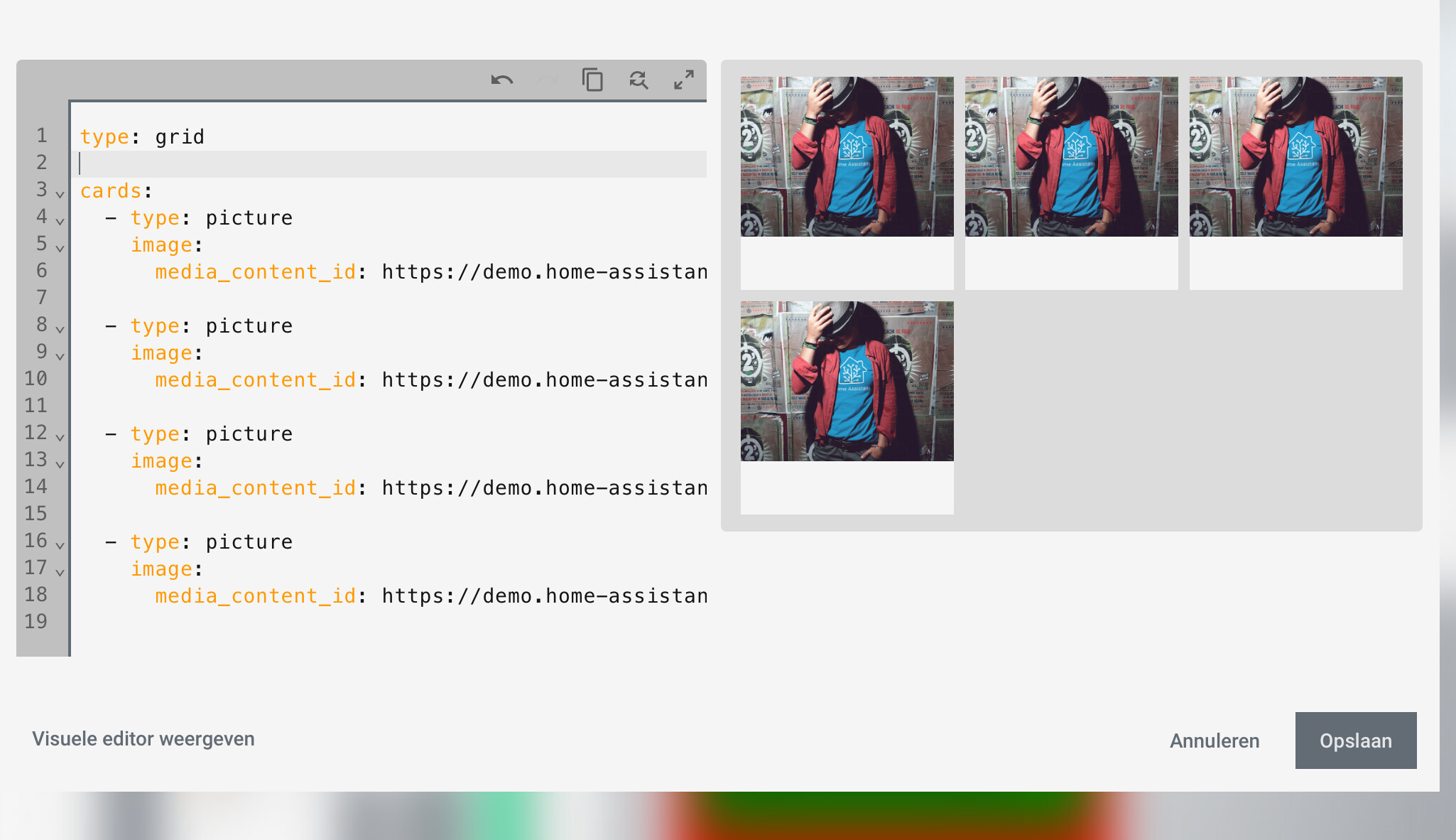

as a suggestion, did you try a grid card?
you can set option square: false and make those images show nicely

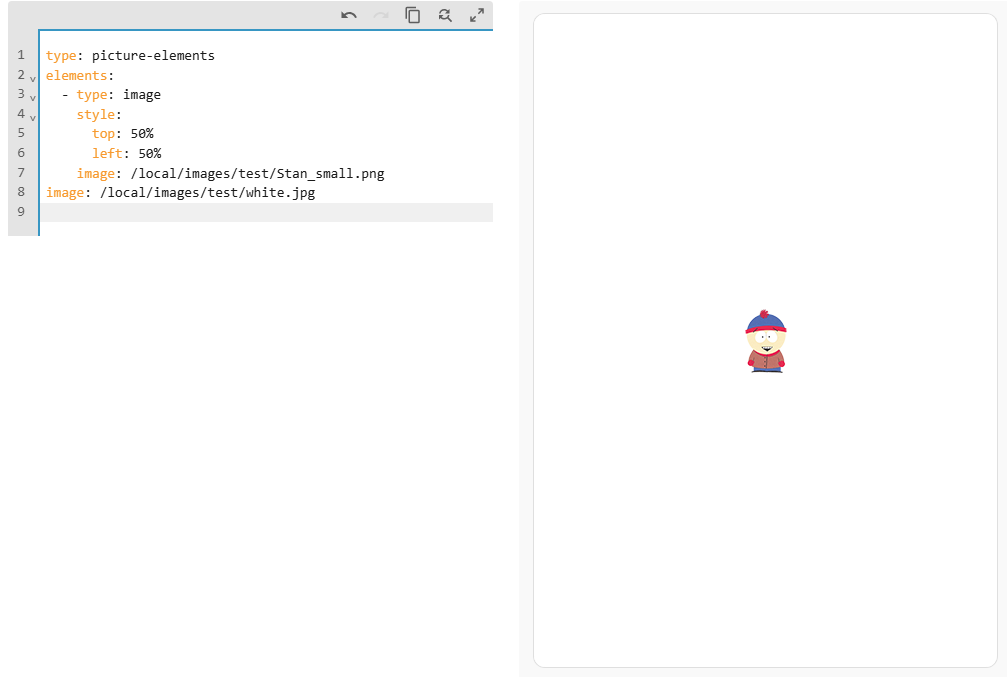

Away from a PC, typing from a mobile, can you test a picture elements card? This allows to place images centrally. There are of course plenty of other ways, but try the picture elements way, at least for learning:
type: picture-elements
elements:
  - type: image
    style:
      top: 50%
      left: 50%
Yes, I do use grid, tried both options but this doesnt effect the result.
What i want to do is to center the picture inside a card.

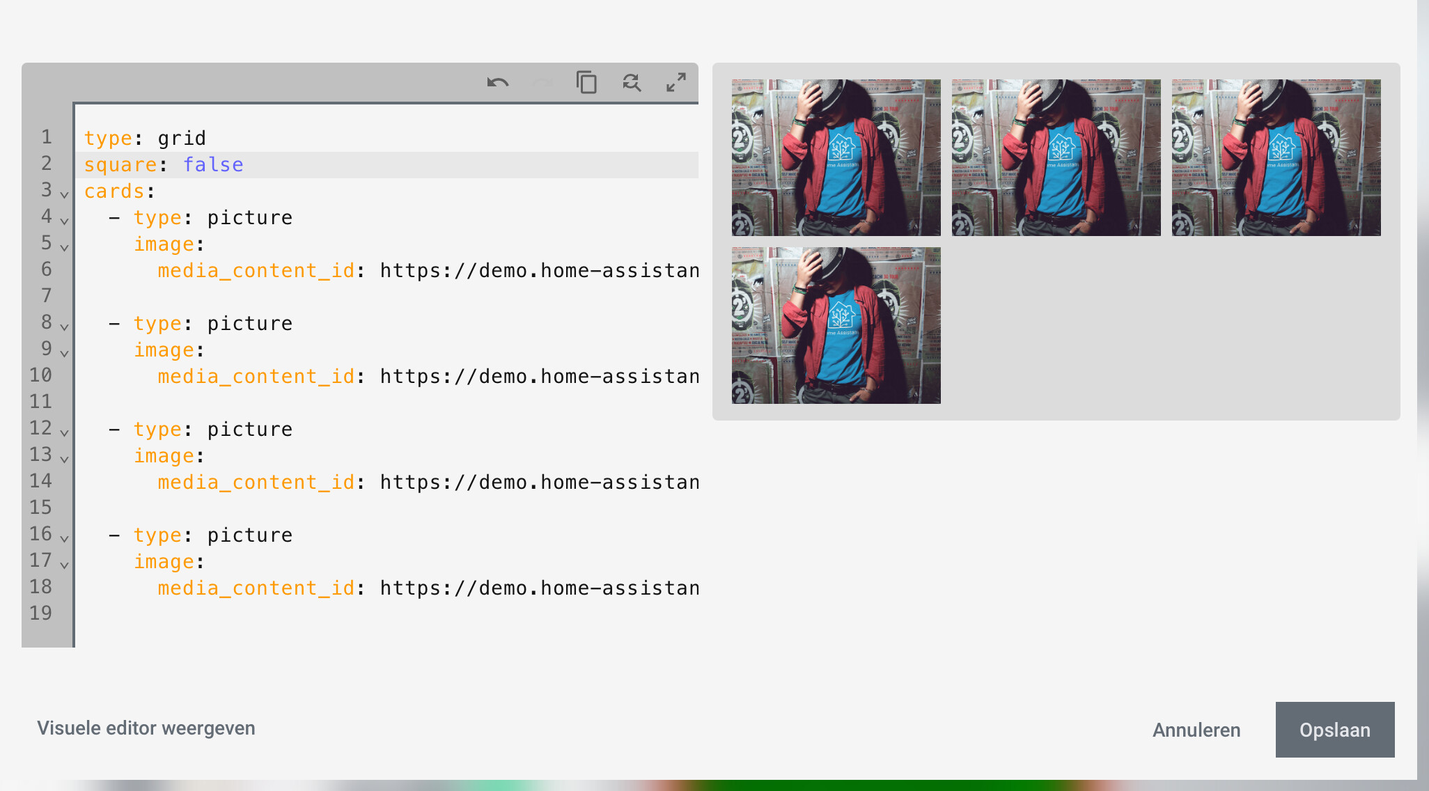

type: grid
square: false
cards:
  - type: picture-elements
    elements:
      - type: image
        style:
          top: 50%
          left: 50%
    image: /api/image/serve/3b38e16f0fb39ef90fd471cc70f1690f/512x512
    grid_options:
      columns: 2
      rows: 2
  - type: picture
    grid_options:
      columns: 2
      rows: 2
Any more ideas on that?

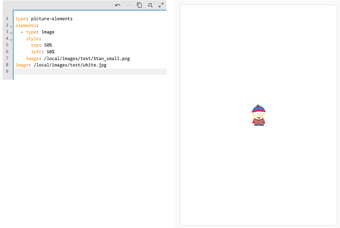

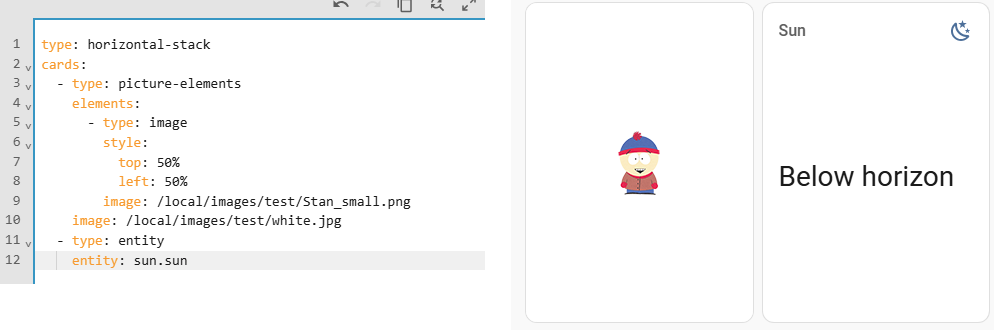

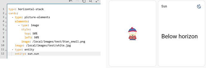

Well, as I suggested:
type: grid
columns: 2
cards:
    elements:
      - type: image
        style:
          top: 50%
          left: 50%
        image: /local/images/test/Stan_small.png
    image: /local/images/test/white.jpg
  - type: entity
    entity: sun.sun

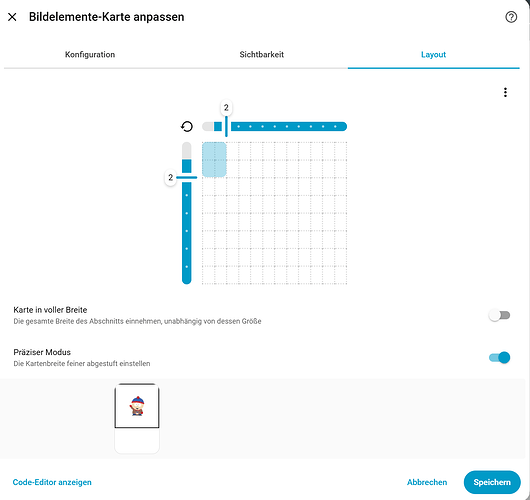

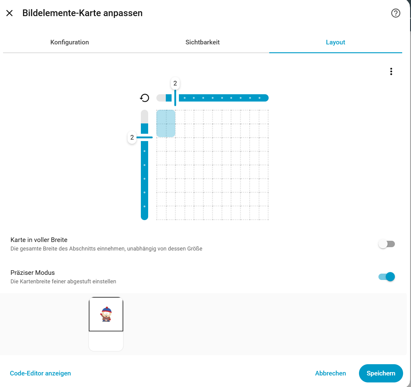

it does not work if I’m adding Grid Options
grid_options:
  columns: 2
  rows: 2
grid_options:
  columns: 2
  rows: 2
elements:
  - type: image
    style:
      top: 50%
      left: 50%
    image: >-
      https://www.partyrama.co.uk/wp-content/plugins/partyrama-ecommerce-pro/includes/pro-images/prod-img/default/stan-marsh-south-park-star-mini-cardboard-cutout-95cm-product-image-500px.jpg
image: https://upload.wikimedia.org/wikipedia/commons/3/38/Solid_white_bordered.png

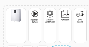

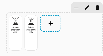

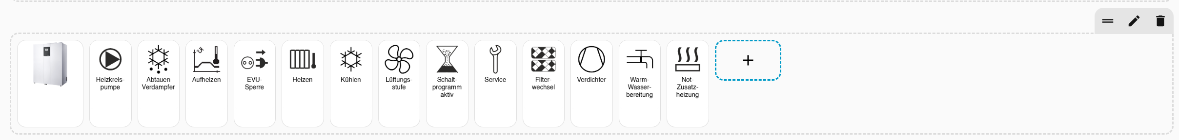

My idea here is, that I’m showing a few of my heatpump status like on the display only when they’re acitve. So i dont want to setup a fixed grid as then i would have alot of empty columns.
Here are all status options:

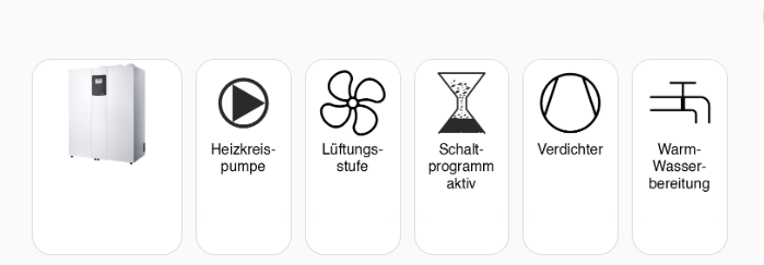

And this it what it looks like when its running:
Hi community, has anyone a idea of how to center the graphics, is it really not possible?
