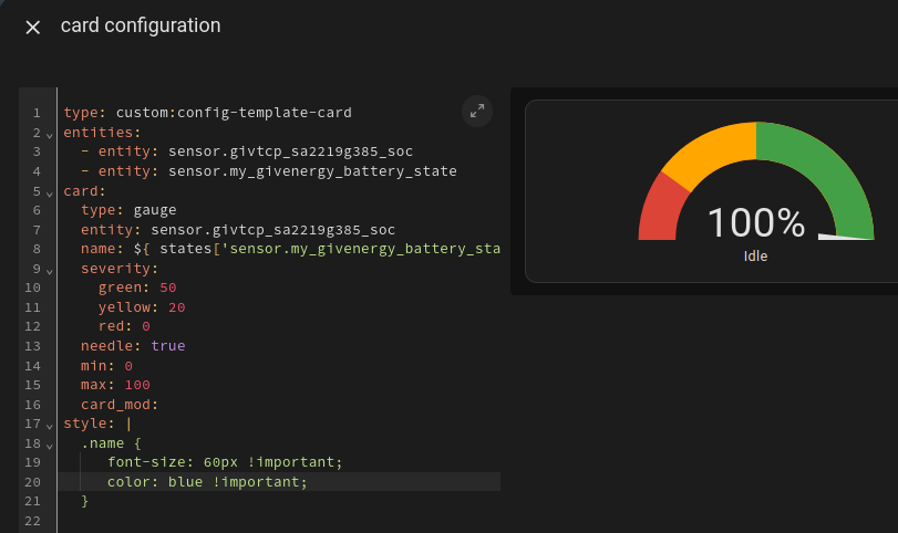

I would like to change the text size in this Gauge Card.
And this is my yaml and the text in question is for the name: entry:
type: custom:config-template-card
entities:
  - entity: sensor.givtcp_sa2219g385_soc
  - entity: sensor.my_givenergy_battery_state
card:
  type: gauge
  name: ${ states['sensor.my_givenergy_battery_state'].state }
  severity:
    green: 50
    yellow: 20
    red: 0
  needle: true
  min: 0
  max: 100
I have been typing variants of:
card_mod:
  style: |
    ha-card {
      font-size: 800px;
In various lines at various tab - with no success whatever!
Any pointers to this bewildering topic will be most welcome.
Regards, Martin

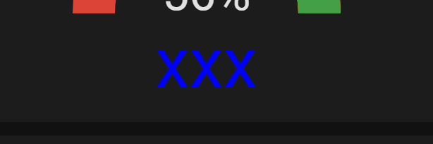

Try
card_mod:
  style: |
    .name {
      font-size: 800px !important;
:arrow_up:
card_mod:
  style: |
   .name {
      font-size: 60px !important;
      color: blue !important;

Line card_mod up like this
type: gauge
entity: sensor.living_room_humidity
severity:
    green: 50
    yellow: 20
    red: 0
needle: true
min: 0
max: 100
card_mod:
  style: |
    .name {
You need to indent style: | and the code below it…
entities:
  - entity: sensor.xxxx
  - entity: sensor.xxxxx
card:
  type: gauge
  entity: sensor.xxxxxx
  severity:
    green: 50
    yellow: 20
    red: 0
  needle: true
  min: 0
  max: 100
  card_mod:
   style: |
     .name {
WoooHoooo…
Thank you.
M.
