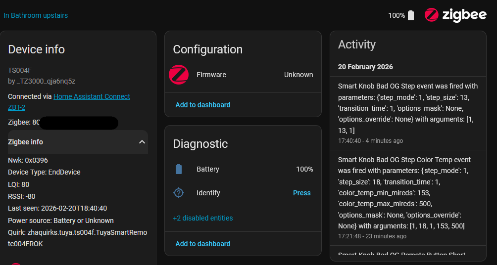

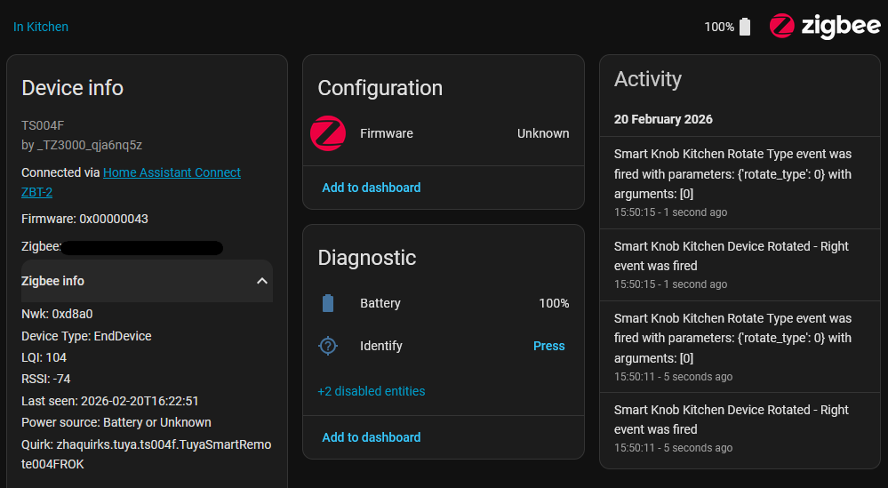

I have 2 tuya rotary smart knobs and both were added flawlessly to HA but when I rotate both of them rights they both fire a different event and on one the double press doesn’t work. Are they different version and each is compatible with a different setup?
I am especially interested in which part of my HA is firing these events when I listen to them in dev tools.

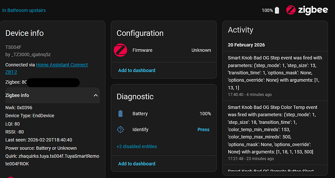

I would say they are exacuthe same, even down to the name of the device.
Sorry. I pasted the same pic 2 times. I fixed it in the post.

I just don’t understand where it decides which “implementation” it uses therefore which events will be provided.
These devices typically have 2 modes (scene mode and remote mode). For most of them, you only need to fast-click the button 3 times to switch the mode of the device. Make sure yours are on remote mode. Scene mode only works well within Tuya’s proprietary system/app.
