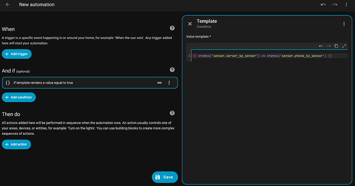

I’m trying to check my phone’s public IP against the server’s and build an automation based off whether those two outputs match. I’m using the DNS IP integration to get the IP of the server, so it’s just a matter of checking the two against each other.
Any advice on the best approach?
Hi, welcome to the forum community and to Home Assistant.
Assuming you already have a trigger for this automation you’ll want to test these two values in a condition using a template condition.
It would look something like this…

This is perfect, thank you!
@HappyCadaver gave me exactly what I was looking for.
Basically I’m checking whether my phone is at home at 7AM on weekdays without the need to enable location services (which seems to be required any other way I tried to set this up, e.g. wifi SSID). I had set it up with a specific public IP, but that changed last week and broke my automation.
