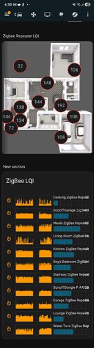

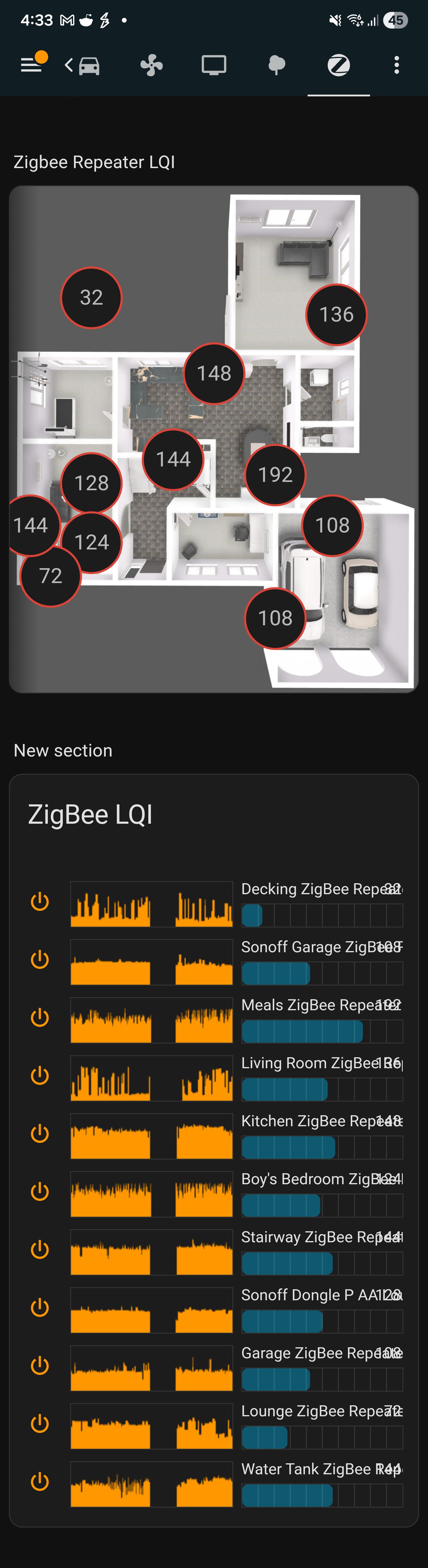

I also monitor my LQI on my dedicated routers to ensure they don’t drop off.
FYI my coordinator (Sonoff Dongle Max) crashed at about 4:30am hence the drop off of LQI. A bit disappointed that I’ve had quite a few crashes requiring a physical disconnect and reconnect to fix. Must be buggy v1 firmware
