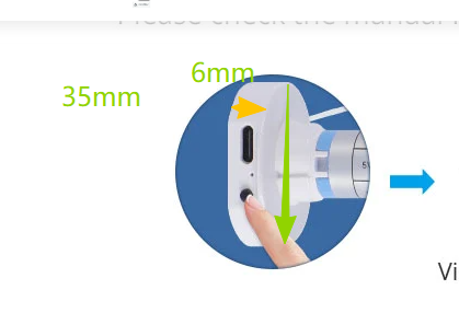

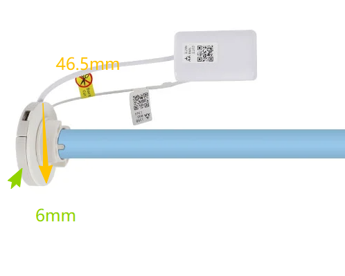

What about the newer MT16B? Isn’t it preferable to the MT15B?
It doesn’t have that thing hanging loose, and it has USB-C instead of Micro-USB. Unfortunately, the piece that sticks out is apparently a little wider.
I’m having a hard time finding the exact measurements.
How many millimeters are the MT15B and MT16B on the piece that sticks out? (The part where the USB connector is.)
This is relevant, as my roller blinds sit inside the window frame itself.
hi kindly check the attachment, i attched two pic for you to refer the size.
