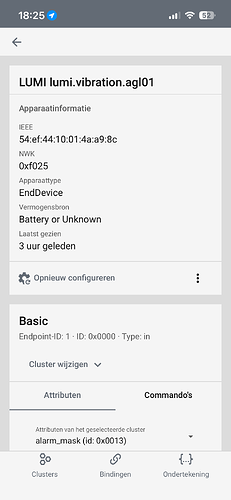

### Problem description
I just got myself a new Aquara vibration sensor lumi.vi…bration.agl01 (DJT12LM). It is detected by ZHA, but Configuration takes a very long time and no useful sensors are added, only "IAS Zone" whatever that may be... So I assume that there is no support for this model yet in ZHA? Can this be added please?
### Solution description
Support for the new zigbee 3.0 aqara vibration sensor
