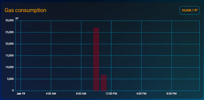

Because the current state of sensor.tank_2_lp_gas_retail_gallons is 140, I changed the template sensor to this:
{{ (140-states('sensor.tank_2_lp_gas_retail_gallons')|int)*35.97 }}
And I forced the state of my utility meter entity, propane_consumption_total, to 0. The only trouble is, I still have some artifacts from its earlier states in my dashboard:
I guess the only way to get rid of these would be to delete that utility meter entity and start using a new one with a different name…
And, I’m guessing that when my template sensor goes negative (i.e., tank level > 140), that won’t matter as the utility meter will only log net increases?
EDIT: I’ve just used Dev Tools → Statistics for the first time… I’ve never had reason to check that out. I was able to clear out old states of that utility meter entity.
