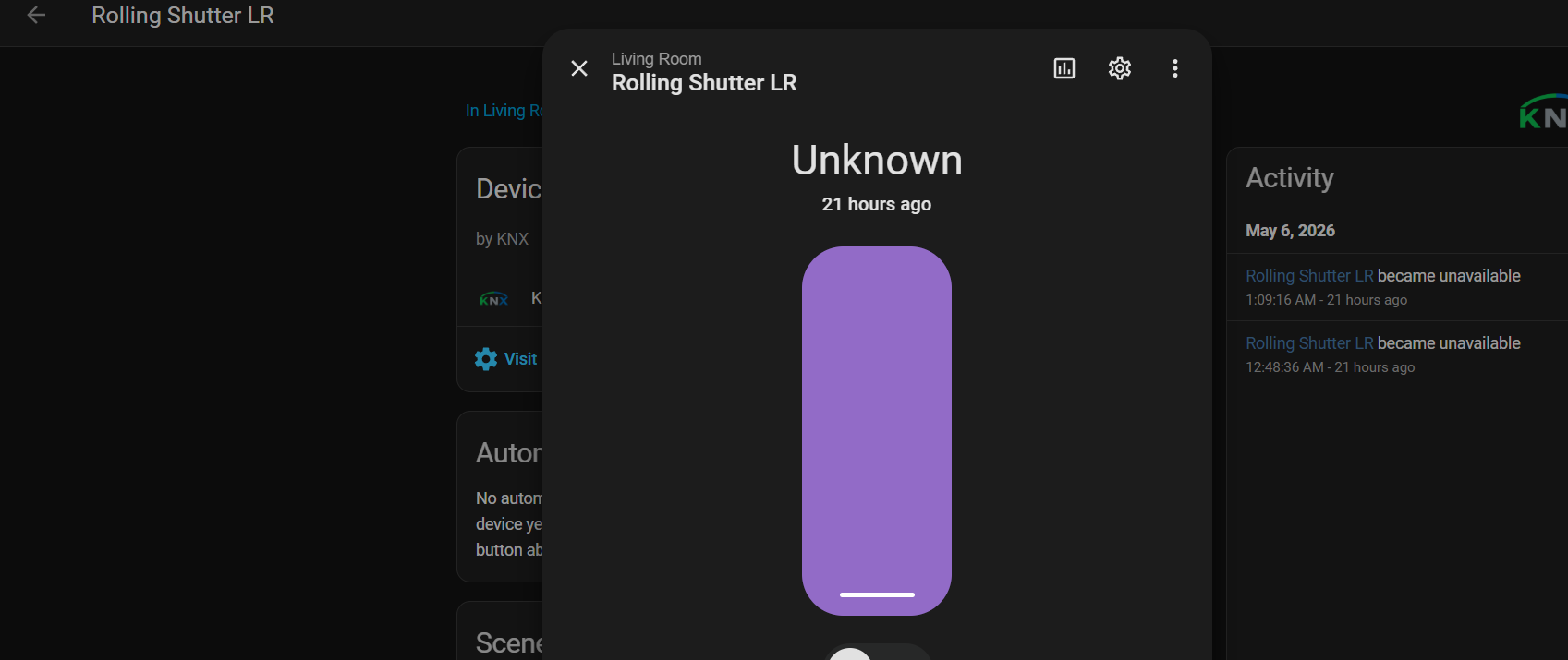

How to configure KNX entities to never lose state
I am desperately trying to find out if there is a way to configure knx entities in home assistant to not lose their state after some hours and instead just stay on the last known value.
I have a problem where i have a rolling shutter device that seems to have status endpoints and callback endpoints but doesnt trigger updates on those at all.
Therefore i would really like to just set an entity to never go unknown/unavailable unless maybe contact to the IP bridge is lost - right now it feels like the options just let me chose between options where after 24 Hours of no change all my rolling shutters will look like they’re unavailable just based on the fact that i dont move them and i dont have a group address to re-read the current status

I just looked at the state again - the value is "unknown" not "unavailable" if that matters.
