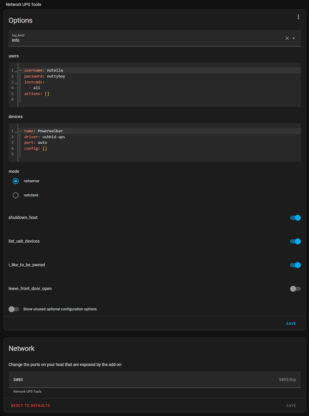

  • Tried deinstalling and reinstalling the addon. No change, same thing.
  • Tried “leave front door open” and removing username an PW, but then the add-on wont let me save the config because the user and pw is missing (even though that is the purpose of “leave front door open” as explained in the add-on docs).

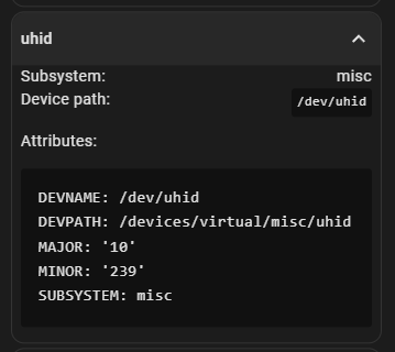

So I checked under “Settings → System → hardware → All Hardware” and there is a whole bunch of things, but not really anything hinting at the UPS. When i search for “UPS” or “Power” nothing comes up. The USB devices available just seem to be the USB controllers themselfes.
Unfortunately I’m about 600km away from the set-up (holiday house). I just plugged it in thinking I’ll set it up remotely. Guess I’ll have to wait for any further trubleshooting until I’m back there in a few weeks…
Maybe the USB ports on the RPI have to get fully reinitialized after you did plugin that USB cable coming from the UPS. Have you tried a full system reboot (not only a HA restart)? Worth a try.
Did that just now (didn’t even know that option was there tbh). USB devices still don’t show anything realted to the UPS, however I’m seeing something called “uhid” - kinda similar to the driver name “usb-hid”? Not sure if that was there before the restart.
Still the same log and stopping sequence when trying to fire the add-on up.
I am now back on site and have unplugged / replugged and switched between USB port, as well as rebooteed the whole system repeatedly - yet no change whatsoever.
The UPS add-on still stops with the same errors in the log.
I still don’t see any device hinting at a UPS in the hardware list - but maybe I’m looking in the wrong place or for the wrong thing?

I wonder whether there is a default login/pass that you are supposed to use with the device, as opposed to making up your own (nutella).

From all I know, connecting to the UPS via USB does not require a Usrname or PW. There is also no way of specifying one in the Add-On.
I’m not sure you are aware: The absurd thing about NUT in HA is, that the “device” the NUT Integration is trying to talk to is actually the NUT Add-ON running in HA as well.
So for whatever reason it was deemed clever to split this into two parts:
  • First an Add-On that virtualizes a NUT server. There you have to define a Username and PW for said server, it won’t let you leave that empty. This Add-On should talk to the UPS via USB.
  • Second, a NUT integration that should integrate the data provided by the NUT server into HA. To let the integration talk to the server you need to provide it with the Username and PW you defined in the server set-up.
So the Username/PW is not relevant for the UPS, but is only there to secure the communication between two pieces of software (the add-on and the integration) both running inside of HA!
