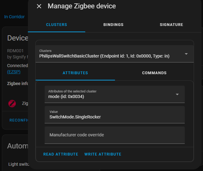

Just a little input that could help some of you:
On my RDM001, I had today actually human readable values in the mode. Also see the Cluster is not the same as mentioned in the post. I tested to write “SwitchMode.SinglePush”, “SwitchMode.SingleRocker”, “SwitchMode.DoublePush” and “SwitchMode.DoubleRocker” and all work and seem to have the desired behaviour from the log, thus, as you see, I use it as a Single Rocker and just read the release event to toggle my light.
I still hope it can help someone because I had absolutely no useful hit in google with these attributes I was reading from the cluster mode attribute.
Hi nannyy,
thx a lot for the fresh info. I have many RDM001 switch modules and I don’t get this new cluster. Do you use a quirk file?
I try to change the mode to doublepush, but I don’t get it.

Ohhhh this is very cool!
I also dont see the cluster:
Same problem here… no matter what I do, I can’t get the PhilipsBasicCluster to show up.
