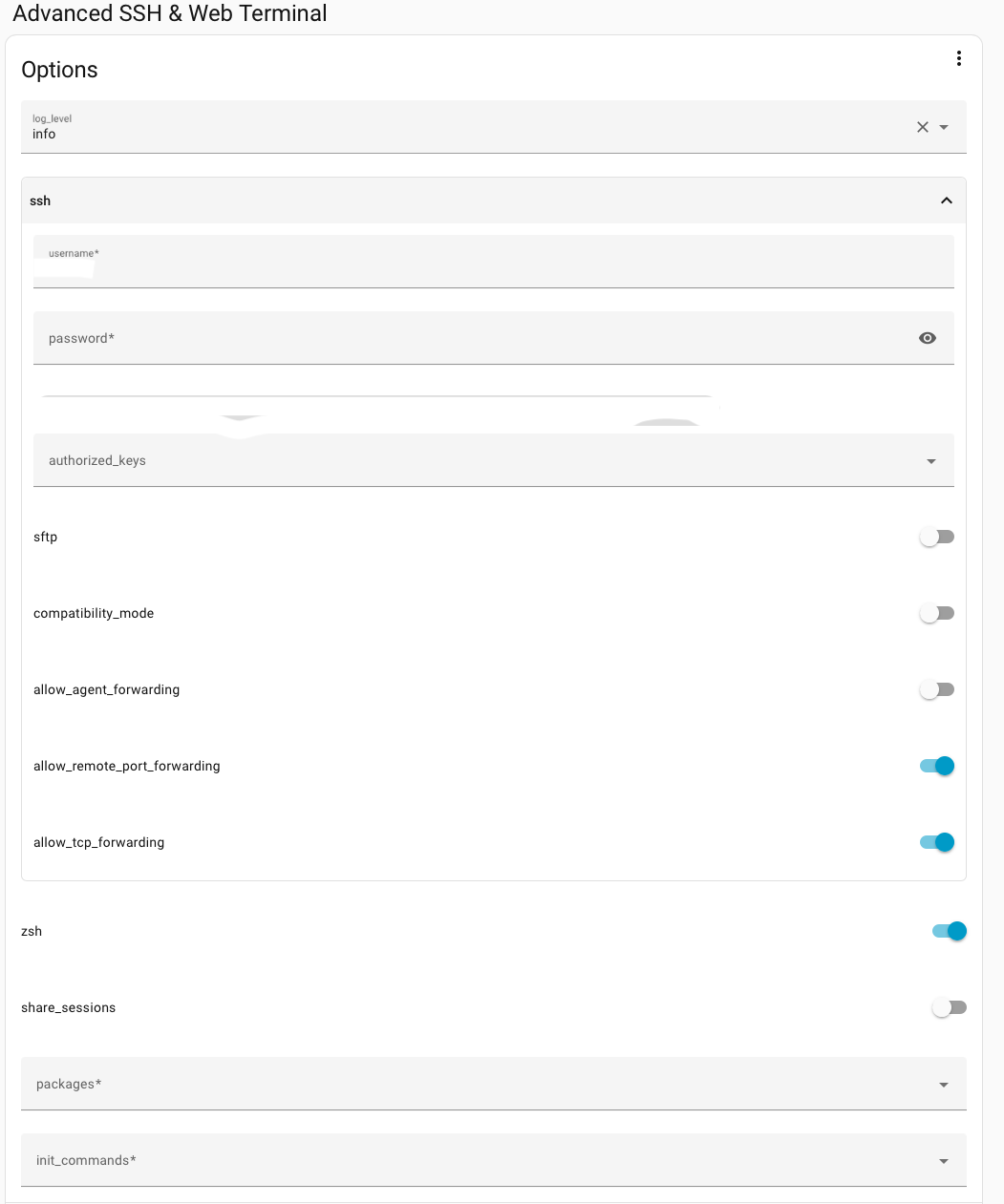

Running latest HA and ‘Advanced SSH Terminal’ add-on and cannot seem to get this to work.
In terms of vscode, I have: Version: 1.99.3 (Universal), and I also found this.
My config:
ssh:
  username: hassio
  password: ""
  authorized_keys:
      ssh-rsa
  sftp: false
  compatibility_mode: false
  allow_agent_forwarding: false
  allow_remote_port_forwarding: true
  allow_tcp_forwarding: true
zsh: true
share_sessions: false
packages:
  - grep
init_commands:
  - cat /config/aliases >> ~/.zshrc
Tried adding package procps and it doesn’t work. Tried adding apks for procps and it doesn’t work either.
In VSCode I always get message: Error: ServerFailedToStart (The VS Code Server failed to start).
In detail log, I also found error message: Error relocating /data/.vscode-server/bin/17baf841131aa23349f217ca7c570c76ee87b957/node: fcntl64: symbol not found
Any ideas?
Thanks in advance.
I just tested mine and it works fine with the same config as you under the ssh: key. None of the other stuff starting with zsh is configured or needed for vscode to work for me.
