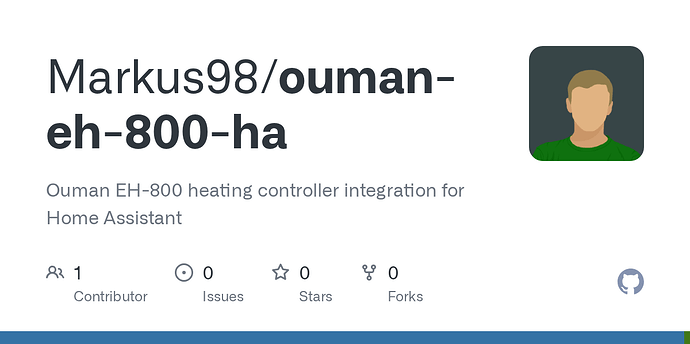

Hey everyone!
I created a custom integration for the Ouman EH-800 which is configurable via the Home Assistant UI.
It’s available here:
I recommend installing the integration with HACS. It should support almost all the features that are controllable via the Ouman web UI.
The integration detects whether you have room sensors and/or the second heating circuit installed, and only then creates the entities for those features. I don’t have a second heating circuit or the room sensors installed myself, so I wasn’t able to test if control works properly. However, they should be fully supported by the integration. If you end up trying the integration, please let me know if you run into any issues!
The information in this thread was very useful for development, so thank you to everyone who contributed to this thread in the past.

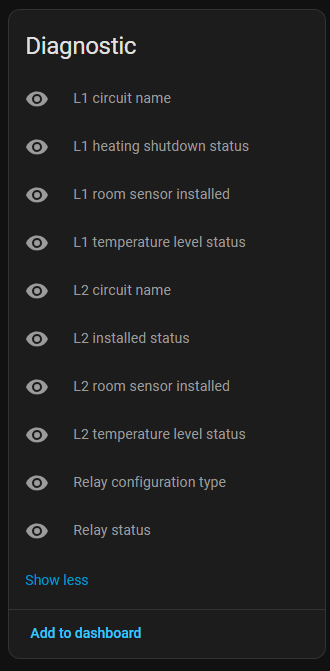

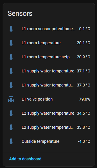

I have already integrated my Ouman via the old method but I’m here to help you develop the “L2 parts” if needed since I have that (all working via old method).
Since I have a complete installation already with automation’s and so on that I don’t want to mess around with I have spun up a virtual machine and installed a fresh HA with your addon (the manual way, no HACS) all seems to be working except I assume some L2 stuff are missing, I can see the following
Let me know what you want me to test, also, do you want to continue here on the forum or should we continue on Github via a Issue?

I have not enabled anything manually in case you want to test things, I figured it will enable all things automatically if detected.

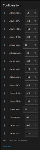

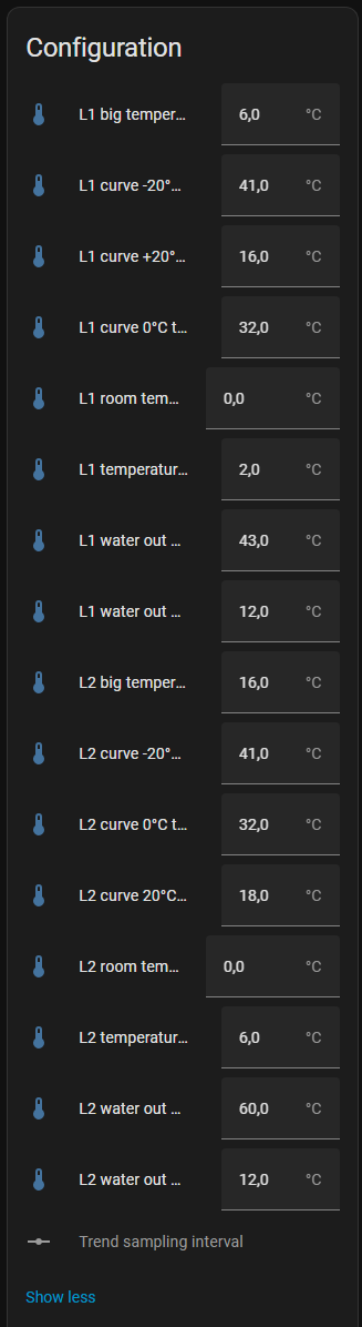

First of all, thank you! Also sorry for the late reply, it seems like I did not have notifications set up properly for this forum.
If you are still willing to help me with the L2-related testing, I would very much appreciate it. I have created a GitHub issue for further discussion, so I would appreciate if the more technical details are discussed over there.
All of the L2-related sensor and control endpoints are defined here. From what I can see, you have everything visible that I have defined within the API. I assume that you do not have a separate indoor temperature sensor for L2? This is the thing I see missing from the entities in your screenshot.
I am curious about the things that you think are missing from the L2 parts. If you have the endpoint IDs for those and maybe screenshots from the Ouman webui, then I would definitely be interested in adding them.
The integration should automatically discover which additional modules you have, such as the inside temperature sensor and L2 parts. I am glad to see that it discovered those parts correctly since I was unable to test that one. If you have the L2 room temperature sensor installed, then something is wrong with my implementation, since it should have detected that as well.

Regarding what might be missing and so on I need to check again, can’t remember the details now, maybe I was thing think about those disabled entities I posted or something, either way I will report my finding in the Github issue instead!
I don’t think you can have two room temperature sensors, only one and I have that and in controls the floor heating valve on L1.
