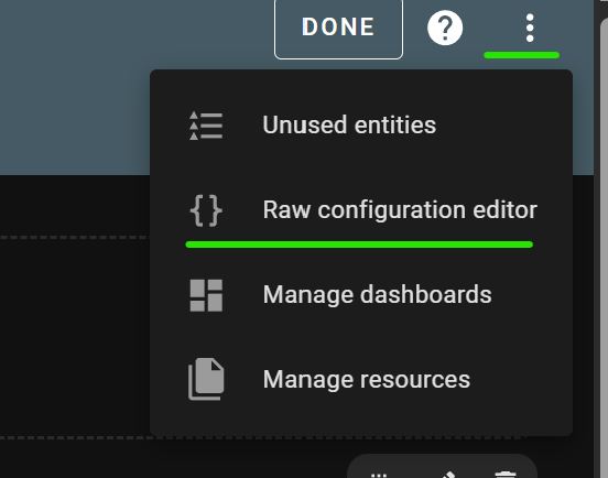

One method I use quite often when building parallel test systems:
1. Click on the 3 dot menu in the right top corner of your overview.
2. Open the raw configuration editor.
3. Copy and paste the data into a txt file on a PC.
In the new system, use the raw configuration editor to add the saved lovelace data.
If you rename the device/entities to match the old system, the lovelace will work fine.
