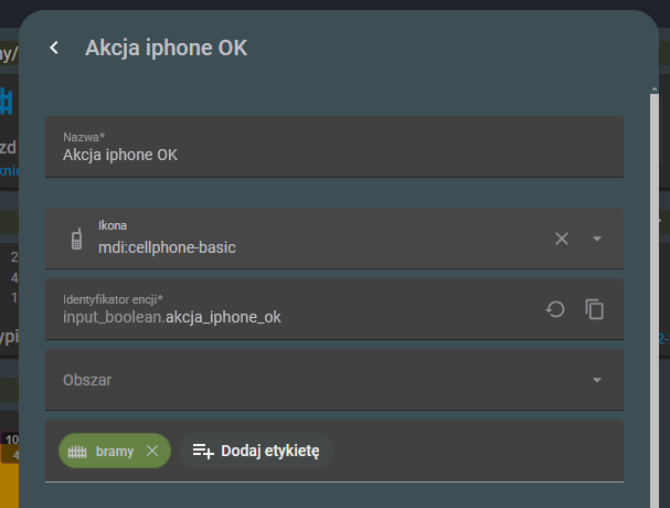

I recently updated my main installation from version 2025.12.x to 2026.2.3. Now I can’t figure a way to copy the icon name used by an entity. Previously, I would open the “More Info” dialog and copy it there (either directly or from the icon picker). But now I can’t select text anywhere.
What kind of entity it is?
Can you post a more-info for it?
I used this method to search and preview icons, which I do quite often when designing a piece of UI: press E, pick random entity, click “settings” (cog), look for an icon, and just close that window. Or perhaps you know of another handy way to quickly search for icons with the option to copy them?

Thanks guys, I ended up using a custom button with an embedded icon picker to copy the selected icon’s name to the clipboard. Works with my Firefox, can’t say for other browsers.
