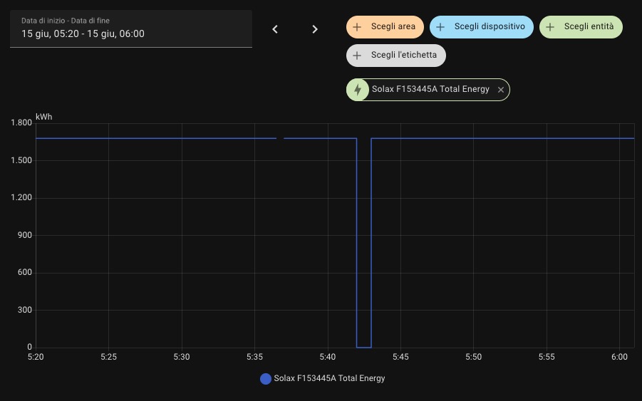

Sometimes I see solar graphs made like this:
And while it would be nice to have a 1.6 MWh output from my solar panel i kinda doubt that is the case.
I noticed that for that day there is a wired gap in reporting
This comes directly from the solax integration, do you think it’s an integration bug or can it be fixed by configuration ?
Oh I think it’s a bug solax Total Generated Energy resets to 0 multiple times when the inverter starts in the morning · Issue #146493 · home-assistant/core · GitHub
