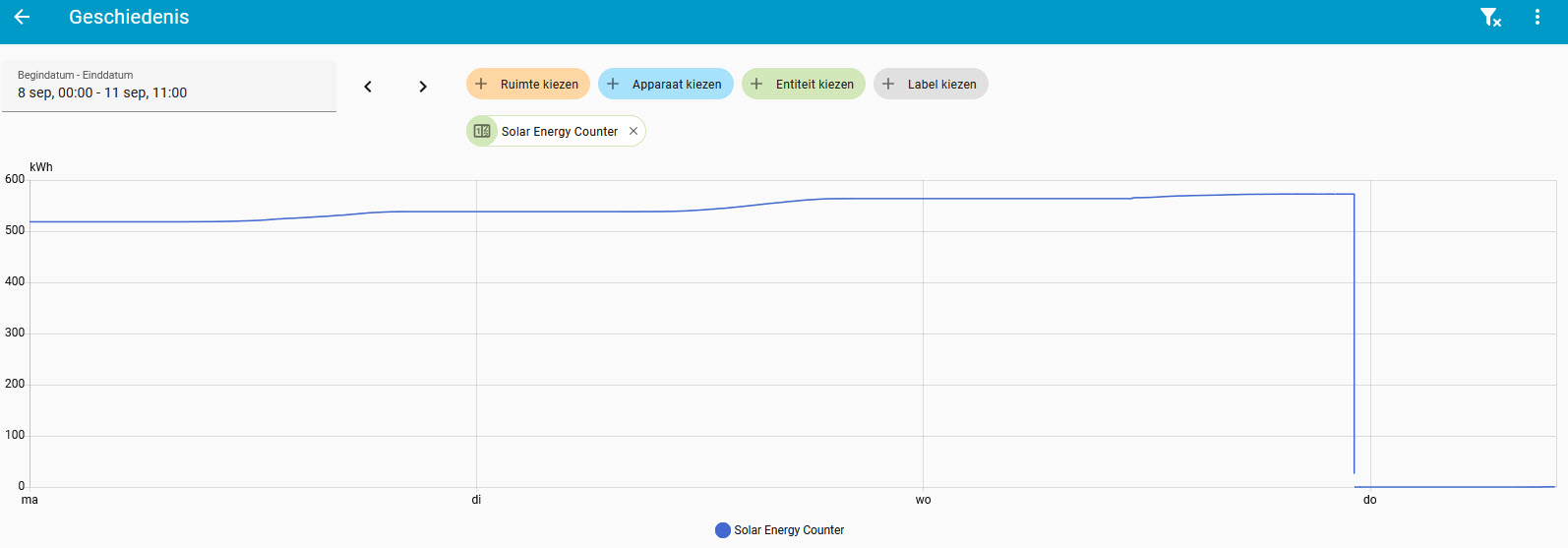

But after updating yesterday evening the HA Core system I noticed the counter went from 565kw to 0 so something has been reset and it’s counting now from 0 again.
Is there a possibility to add a certain value in the automation in such cases once so the counter is going from 565 instead of 0 and the at 999 it resets like usual?

Please share the history graph of the sensor.

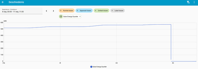

Yes there is an automation but now i did not got the message because it went down to 0 after it was on 572 and yesterday evening i updated HA Core version. But it would be good if I would be able to add somewhere a start number in such cases.

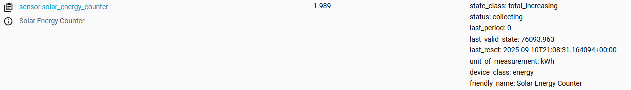

Can you go to Developer Tools → States, find sensor.solar_energy_counter and take a screen shot of the right hand column then paste it here.

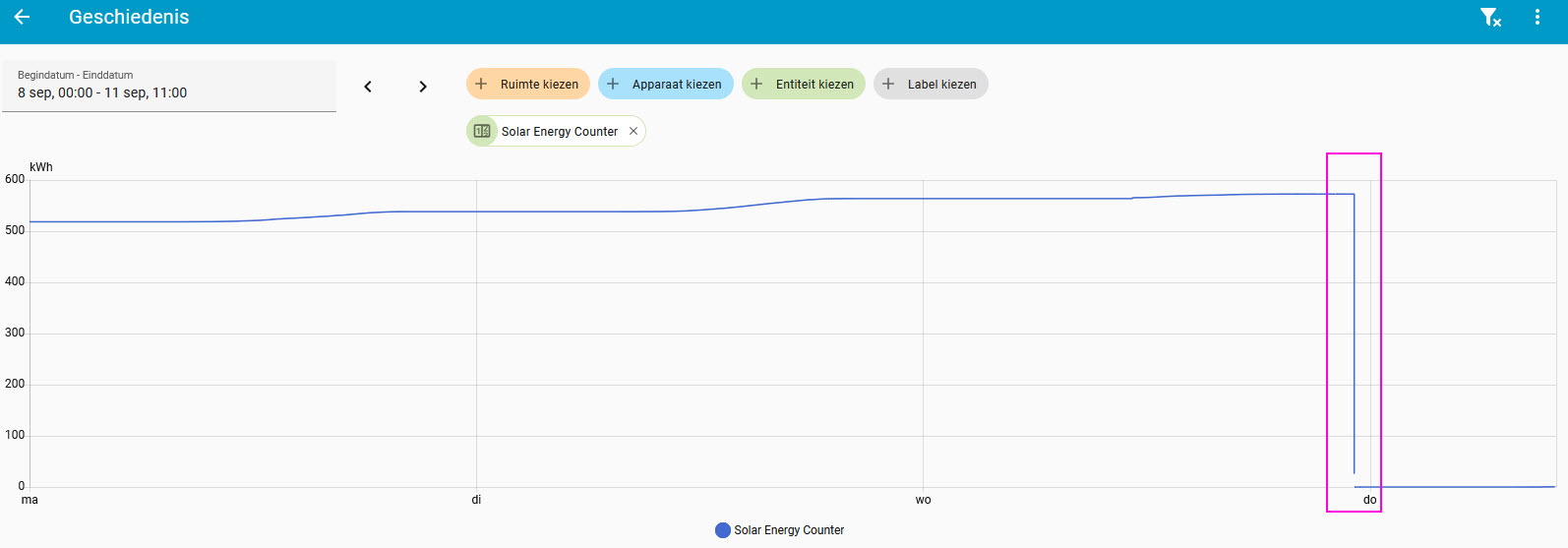

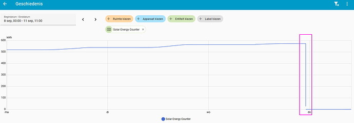

Ok this is weird. This says it last rest at 8 minutes past 9 pm on the 10th.
But this looks to me like it was a lot closer to midnight on the 10th.
I have no idea what is going on.
Yes Tom, that was the time I updated the HA Core version from 2025.6 to 2025.9.1
They are two separate times.
