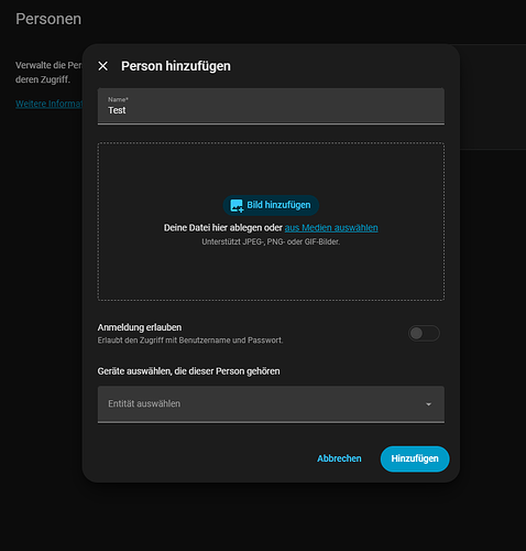

i wanted to add a person to my system what workls but i cant switch the button Login Allowed any one knows why ? i can add a User thtis works fine and he can login but why cant i use the perosn Feature?

yea i did that but the button "Allow Login" ist not avaibel it is grayed out

Did you try the "as per usual" troubleshooting (delete browser cache and refresh browser)?
Are you an administrator in your system?
yea iam on the Owner Profile
sidjohn1:
you should add some pics
here is a pic when i add a user
yea doesent work either
and when you click Hinzufugen you should have a person called test… correct?

yes but i cant do something with it
In another conversation I read that
this is a bug
as a workaround you can create a user and then add person to user
I didn't try this myself
