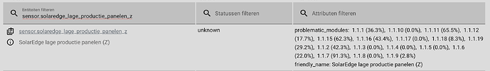

using the example config from the documentation on SolarEdge SQL sensors, I have this entity that has too many chars for its state (which is effectively duplicating the attribute it sets for problematic modules:
and the error that logs is:
Logger: homeassistant.core
Bron: core.py:2358
Eerst voorgekomen: 00:02:16 (1 gebeurtenis)
Laatst gelogd: 00:02:16
State 1.1.1 (36.3%), 1.1.10 (0.0%), 1.1.11 (65.5%), 1.1.12 (17.7%), 1.1.15 (62.3%), 1.1.16 (43.4%), 1.1.17 (0.0%), 1.1.18 (8.3%), 1.1.19 (29.2%), 1.1.2 (42.3%), 1.1.3 (0.0%), 1.1.4 (0.0%), 1.1.5 (0.0%), 1.1.6 (22.0%), 1.1.7 (91.3%), 1.1.8 (0.0%), 1.1.9 (2.8%) for sensor.solaredge_lage_productie_panelen_z is longer than 255, falling back to unknown

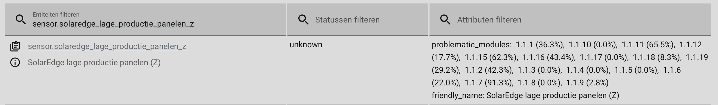

Now this is hopefully not the case too often… but, as we’ve been covered with snow for the last week or so now, I’d love to use another state for the entity, and can do so I think in the options for the entity:
now what should I do to get the number of the problematic_modules in the state?
Or, would there be another more useful method/option to use for these entities (I have several planes of modules)

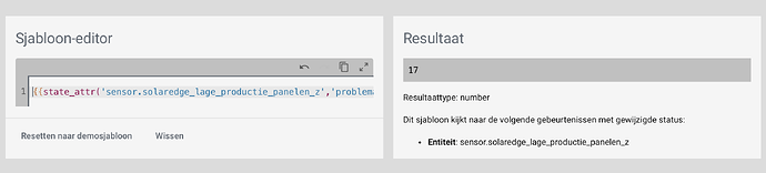

{{this.attributes.problematic_modules.split(',')|count}} would be simplest?
however, doing so still renders unknown, even though testing it in the dev tools shows the correct output

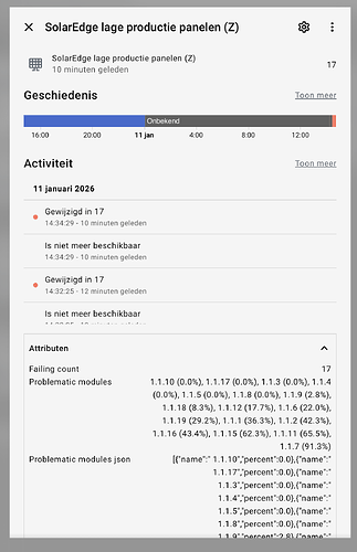

which returns this to me for the query, providing the attributes in 2 versions (JSON for easy templating) and a failing count:

and I do believe this works like I had hoped to.
the count is obvious, the string attribute can be used eg in a Markdown, and the json can be the base for more in-depth templating

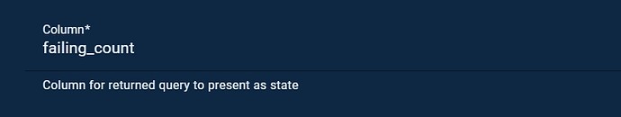

But, as it stands with the SQL query I posted above, I now can simply set the state to the failing_count column.
