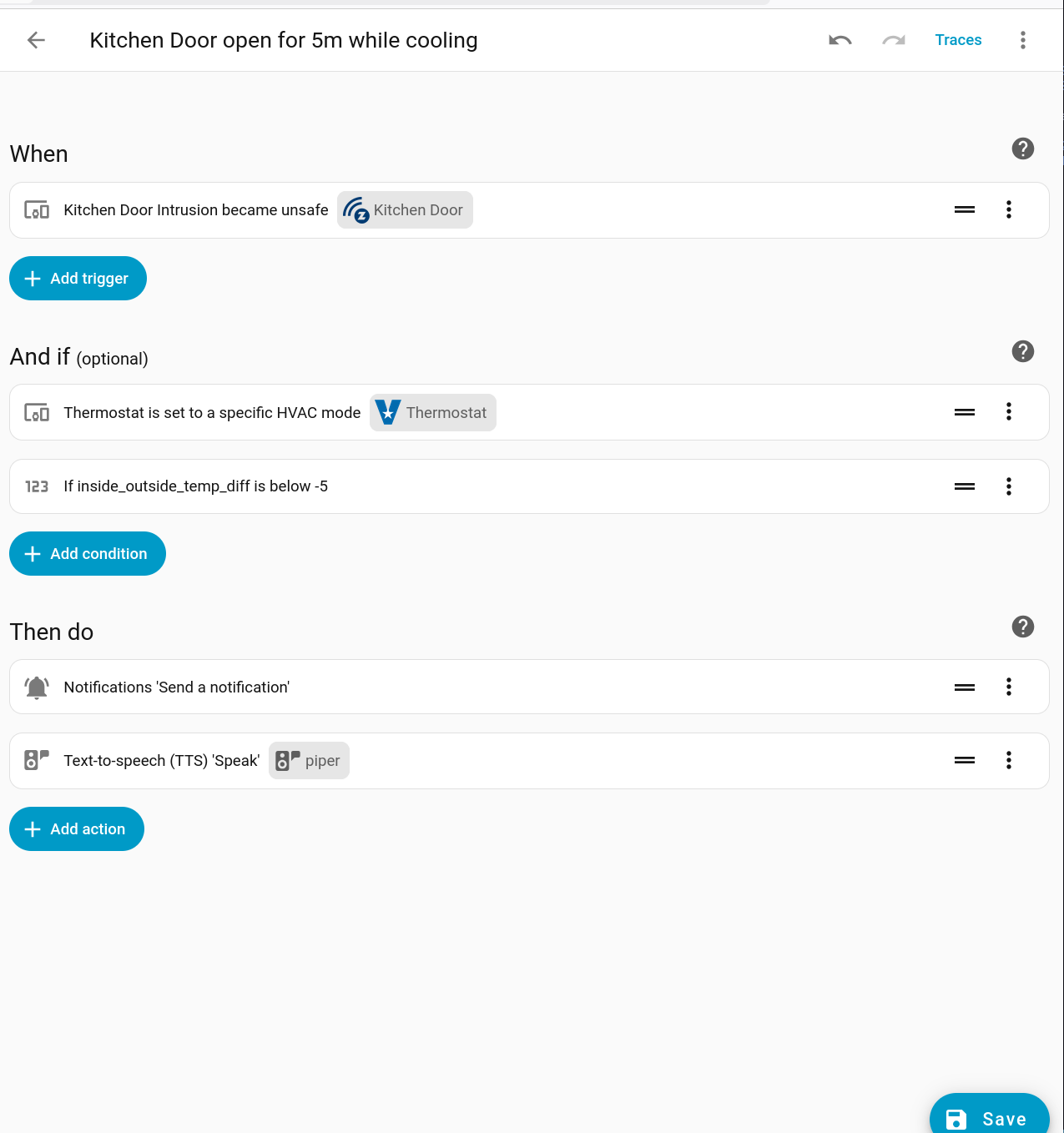

So what I want to do:
When door X is opened for more than 5 minutes AND the AC is set to cooling AND the difference between indoor and outdoor temp is lower than X °C: Send a notification and TTS about this. And if this happens again after 10 minutes, turn off the AC.
Do the same for when AC is in HEATING mode and the difference is above 5°C.
Now I can perfectly do this for one door, I created a template sensor that calcualtes the difference between inside and outside temperature.
But I have more than one door so I would like to make it dynamic. And also doing this for heat and cool would double alll such automations, same with the 5min action (notify) and 10min action (turn off AC) it would be: number_of_doors * 2 (5/10min) * 2 (heating/cooling). Which I could do but maintaining seems like a hassle.
I know I could probably make a template that just checks if any door is open and then react but I do want to notify via notification and tts which door is the culprit. For windows this is much less important and I am ok just having one general “you left a window open” notification.
Is this possible? I attached a screenshot of my single-door, cooling-scenario, 5 minute alert automation:
Try to work with multiple triggers and add a trigger ID to each of them.
Delete the conditions (and if) and add them to a choose action (then do) incl. other actions.
There are a number of ways to accomplish this.
I would probably start with a Template that combines:
  1. Is any door open?
  2. Is temp delta past the threshold for the current HVAC action?
That could be used either directly as a Template trigger or as a binary sensor. Since you are going to need two identical triggers except for the duration, having a binary sensor might be the easier choice long-term.
Naming the door or doors that are open in the message is a pretty easy template, so don’t get hung up on that part.
A custom template would create a macro that you can call with data, so write it once, call it over and over again with the entities in question.
Here’s an example of one of mine… GitHub - SirGoodenough/Availability-Template: Custom Template for checking the availiability of an entity. · GitHub
You may be able to set up a blueprint template for that. This method is not fully fleshed out yet, WIP, but some template types are possible. Again set up the code once, create templates by adding inputs to the code to change things as needed per template. You can get examples of these by pasting this URL into a browser (It’s a search of this site)
Topics tagged template-entity

I was looking at your sceenshot again. Tip: Use entity status triggers, not device.
trigger: state
entity_id:
  - binary_sensor.door_1
  - binary_sensor.door_2
  - binary_sensor.door_3
to: "on"

You can just add all the contact sensors to a group then use something like this:
triggers:
  - entity_id: binary_sensor.doors
    to: "on"
    trigger: state
actions:
  - action: system_log.write
      message: >
        {% set entities = state_attr('binary_sensor.doors', 'entity_id') %}
        Triggered by:  {{ entities | select('is_state', 'on') | list }}
You might need to enhance that, if you want something more friendly than the entity ids. But the idea is that you are using the group both to trigger the automation and to provide a list of entities to loop through to find the offending door.
