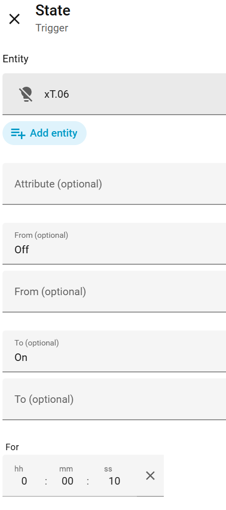

Now I’ve seen that in the event we have the “for” in the event:
does it work in the same way? is resilient at restarts?

No.
From the documentation:
Important
Use of the for option will not survive Home Assistant restart or the reload of automations. During restart or reload, automations that were awaiting for the trigger to pass, are reset.
