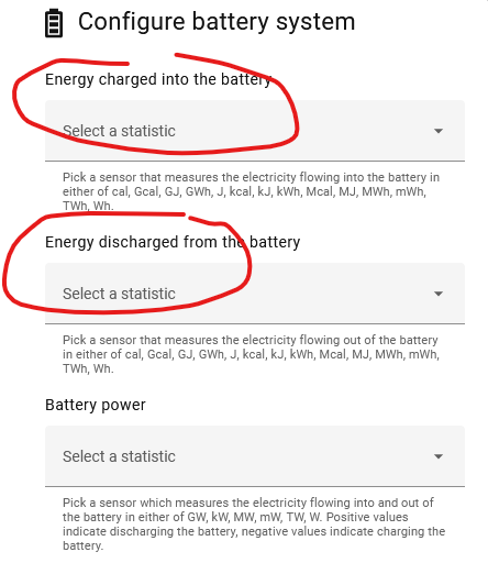

My Homebattery gives me SoC and Power values. Via integral I have generated the Energy value.
Goal is to use this in the enery dashboard but the dashbord editor requests statistics for “Energy charged into the battery” and “Energy discharged from the battery” See the red markings in the hardcopy.
Means: I have to separate the positive and negative power into two Energy integrals. How can I do this?
