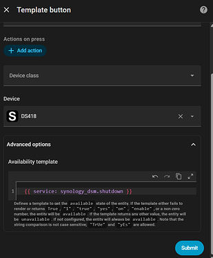

So, I tried creating a button template helper, and am completely stuck. Can anyone show me the correct way to accomplish shutting down the NAS?

No. The action you are using in the WoL switch is depreciated. Not the WoL switch.
I’m pretty sure you don’t need to.

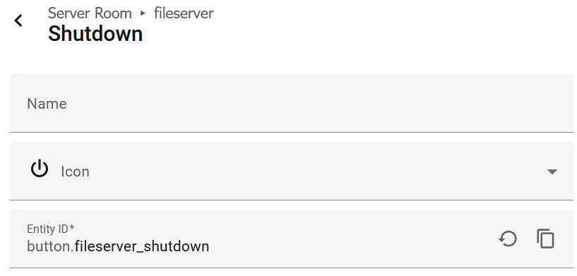

The Synology integration should provide a button as well as that shutdown action (at least until the action is depreciated then it will only be the button). Check the entities available at Settings → Devices & Services → Synology. There should be a shutdown button there.
Absolutely correct …
Thanks for confirming Jeff.
Just to wrap up, this is how you would use that button in your automation to shutdown your NAS:
actions:
  - action: button.press
      entity_id: button.your_nas_server_name_here_shutdown
