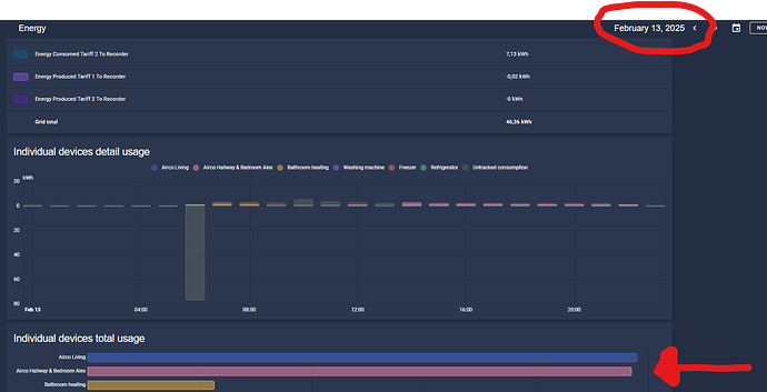

The response of my question is I presume this :
But…why do I still get data on the 13/02 ?
I want a clean start from 14/2…
No. The purge only removes 5 minute statistics. Hourly and daily statistics are never removed.
You can adjust energy statistics in Developer Tools → Statistics. Click on the ramp icon next to your entity.
OK, I set all data of the 13th on zero and now it’s fine.
Thanks !
