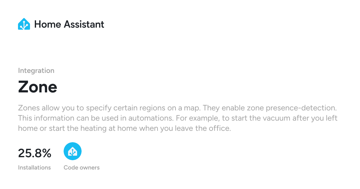

The state of zone.home should reflect the number of Person entities in that zone:
…so unless you have a Person associated with your display tablet, that shouldn’t matter. The device tracker will say home but won’t be counted in the zone state.
