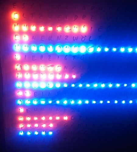

I built a word watch using ESPHome. The configuration allows for the integration of the device into other WLAN networks that do not have a home assistant server…
The user needs to know the new IP adress of the device to access its configuration page. To facilitate this I created a function that uses the clock to display the IP adress.

Your photo is so blurred I cannot see anything except a mass of colored blobs.
Does the access point mode functionality of ESPHome provide for your reconfiguration needs if the IP Address is not contactible?
Blobs that say 192.168.2.175 - so that bit works for him…
