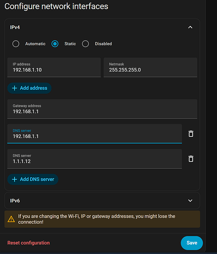

Settings > System > Network > IPv4 (or 6) > delete any extra DNS fields
There is a Save button under the network interfaces section. You need to click save for your changes to apply

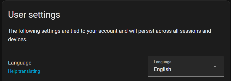

Click your profile icon in the bottom left. It’s the first option under User settings:
Thanks, I had to start over and picked English before logging in this time :slight_smile:
Saving the DNS servers isn’t really helping because the illegal name servers are always being added anew. I entered my own DNS server and deleted the others, but they keep coming back.
I had to add a firewall rule to block them. It would be much better to remove them.

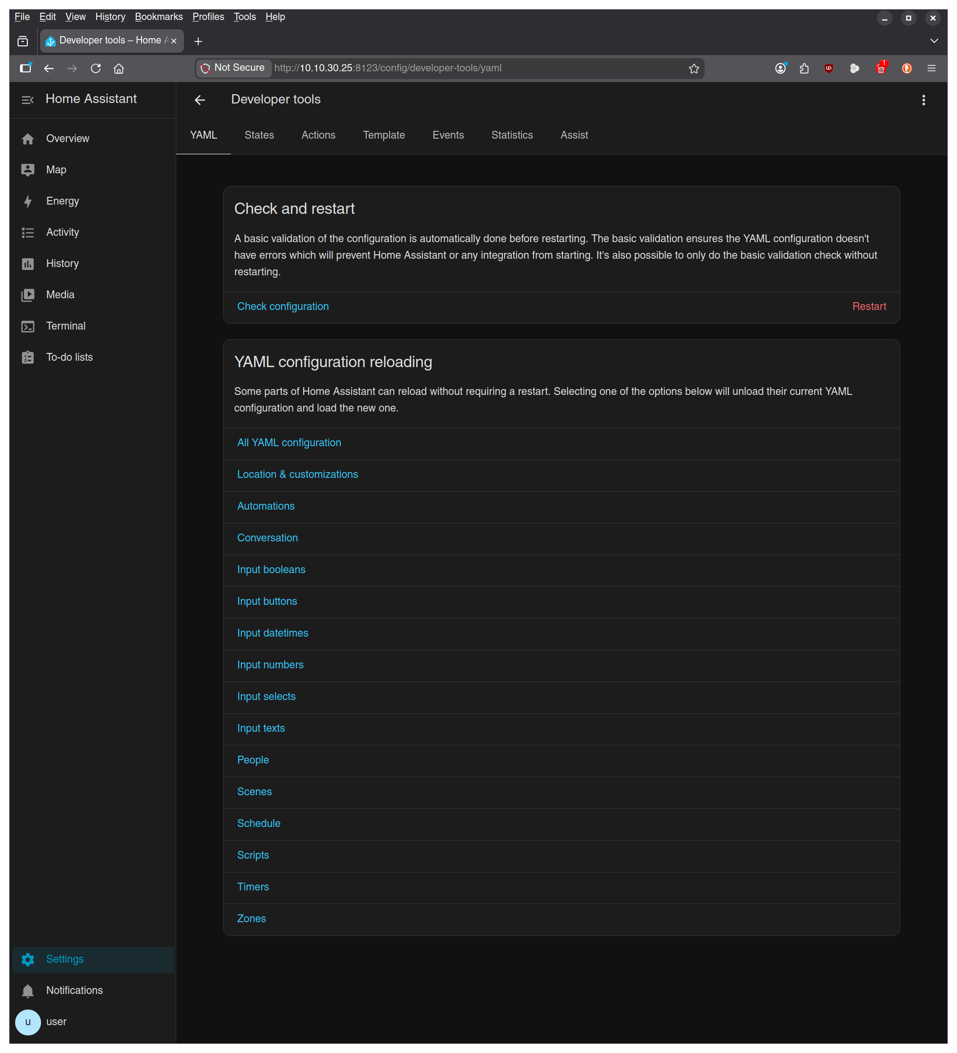

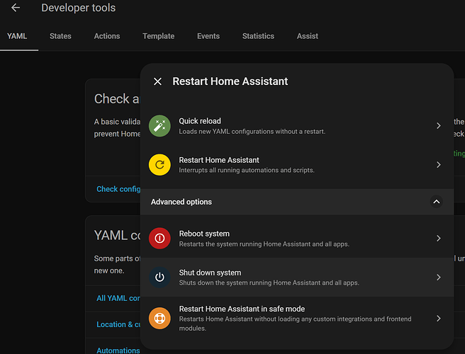

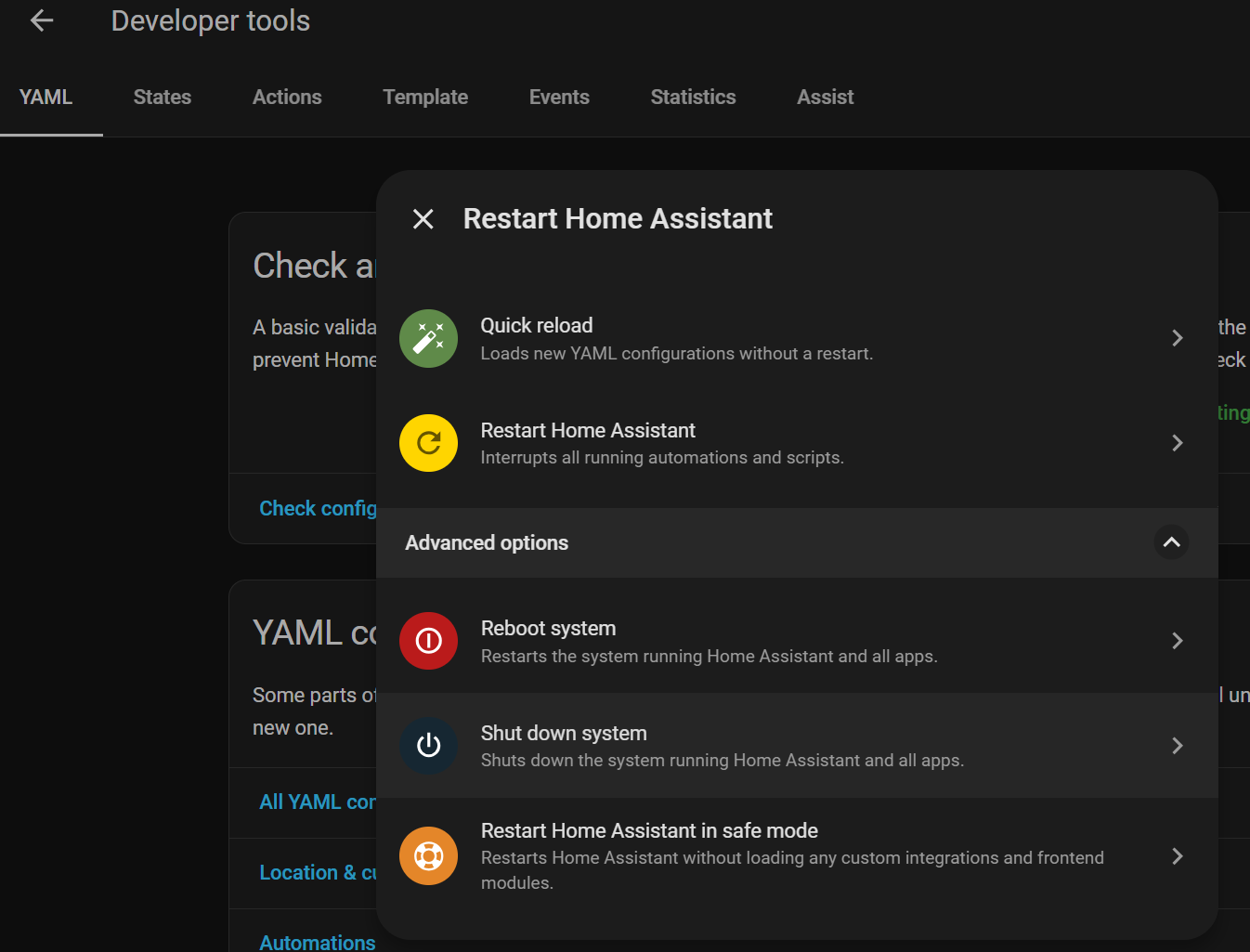

Regarding shutdown, you can do it by calling hassio.host_shutdown or via the Developer Tools > Restart > Advanced options > Shut Down system
Not 100% sure if it will shut down your VM because you haven’t told us what VM you’re running, but it should work

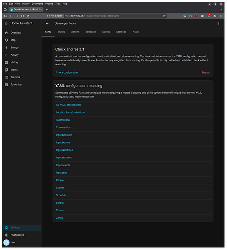

I don’t see a shutdown option in the developer tools section:

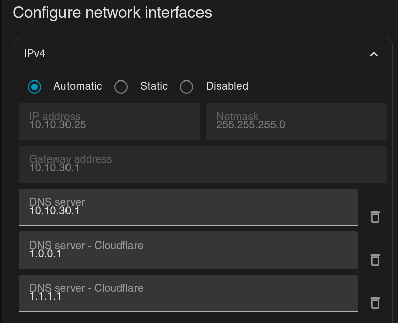

So how do I get rid of the cloudflare servers? I can delete them but they keep coming back:
The DNS servers are coming through DHCP from your router.
You neee to change it there or choose to set a static IP instead.
Oh, you’re right! That happens when abusing a VLAN for a purpose it wasn’t set up for to begin with …
Mate, I made it clear in my steps that you have to click Restart in order to see the additional options.
