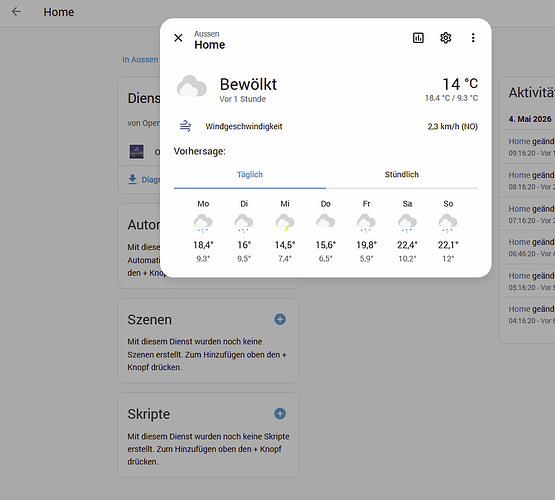

The title doesn’t say much I’m afraid. What I mean is: Things like the Sonoff SWV Water Valve have entities, that are complex … By that, I mean it is not just a single reported number (like a temperature), but in Sonoffs case, complete functionality, like cyclic timed irrigation setup. How do I add this to a HA dashboard, so it shows all it’s got in one go … i.e. the required sliders, fields whatever to use that one function? Something similar is the open meteo “device”, that has one exposed function, that displays the entire weather card, including symbols, weather data, forecast an all in one single “sensor”. I’m confused with all the cards in HA.

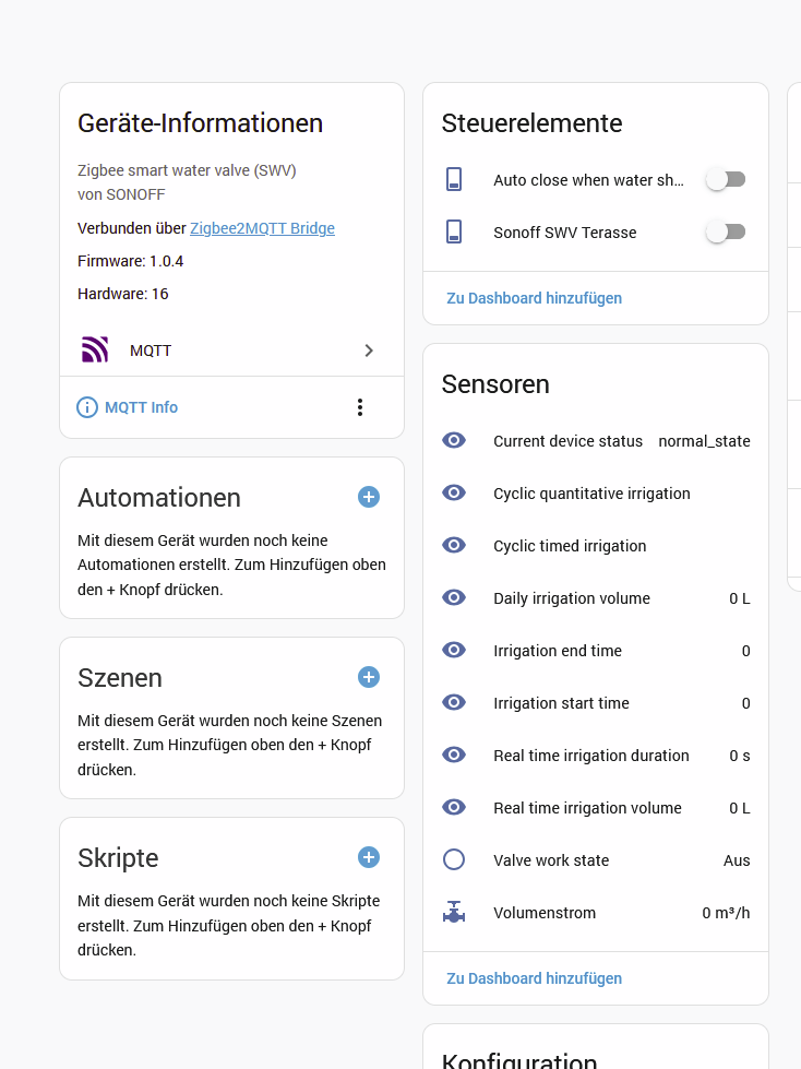

Can you explain by sharing the HA device page for this thing? I assume all these items are control or diagnostic entities, but if you can show it will help

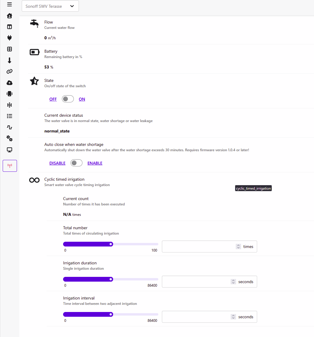

Here’s part of it: Simple stuff like “Battery”; but then below the complex irrigation function:
And open meteo has an antire weather report as a single “sensor”:
this is z2mqtt screen i suppose, can you share how device looks like in Homeassistant devices page?

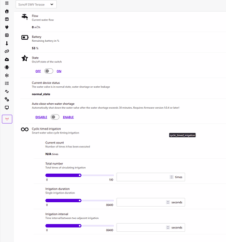

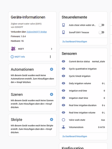

Yes that was the zigbee2mqtt subscreen. That’s it in the devices:
They’re separated here.

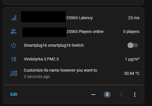

Then use Entity Card I guess.
Entity card gives you a “compact” view and you can just basically throw in all types of entities into it and it works.
Just the entity card didn’t produce much usable for me … I’d like to recreate such a neat setup for irrigation as in the mqtt entity … where I can set minutes and have sliders for that etc.

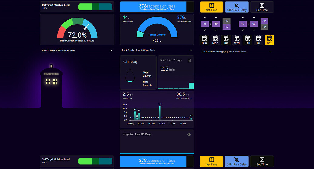

Entities card might be your best bet but you need to think of exactly what you need to see on a dashboard. A lot of those entities are just back-end settings that do not need to be touched.

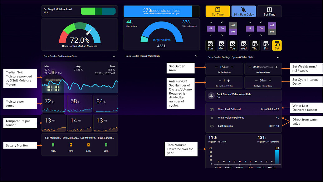

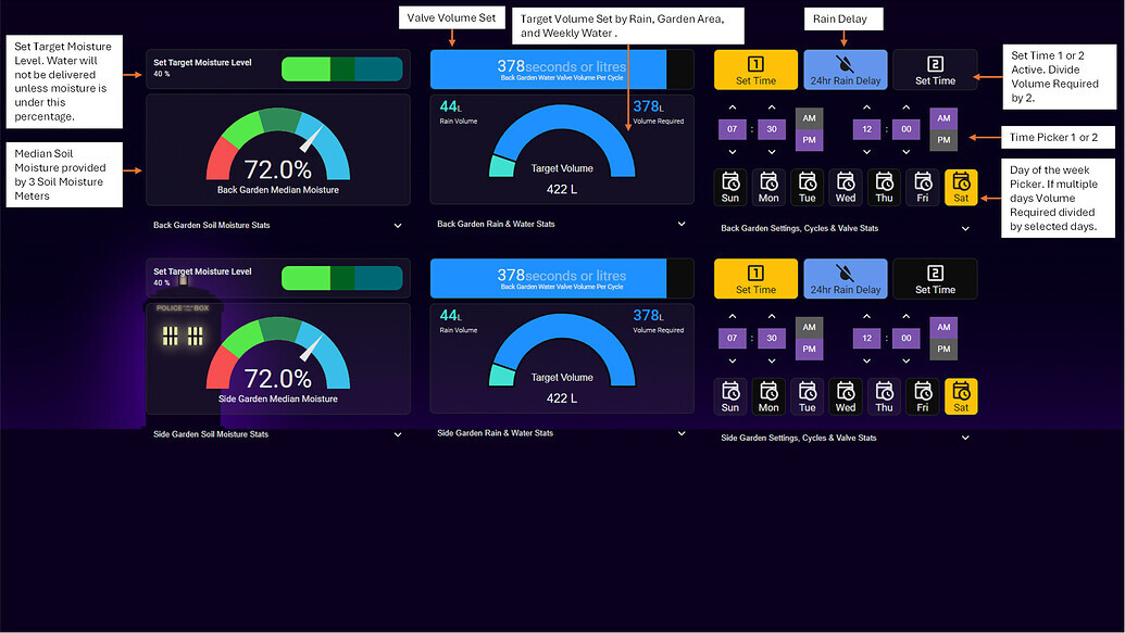

Example of my irrigation dashboard using Giex water valves.
