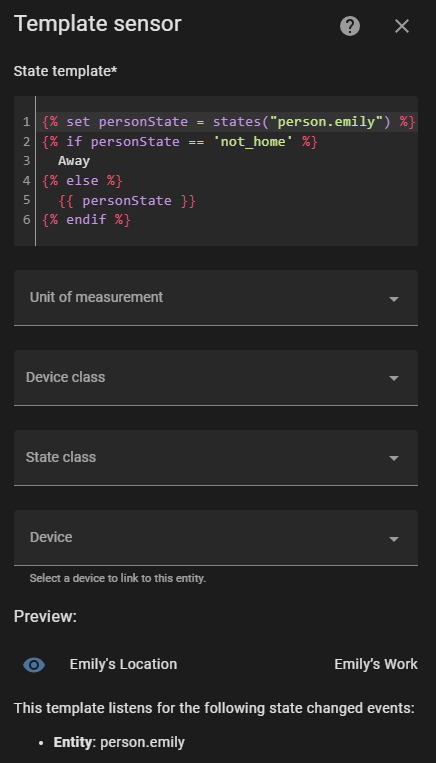

Thank you, @VietNgoc! That is super helpful. Until reading your reply, I had not yet heard of or dealt with templates in Home Assistant. I appreciate you bringing them to my attention.
Now I’ve created a sensor template helper in the Helpers section of my Configuration menu using the code you shared above:
Additionally, I’ve changed the code in my Apple Watch complication from:
{{ states("person.emily") }}
to:
{{ states("sensor.emily_location") }}
Of course, right now the person is in a named zone and not in a not_home or Away state. This means that I cannot yet confirm that this translation is displaying correctly within the Apple Watch complication. But I’ll come back with an update and mark this topic as being solved once I can confirm that everything works.
Thanks again!
EDIT:
It worked!
