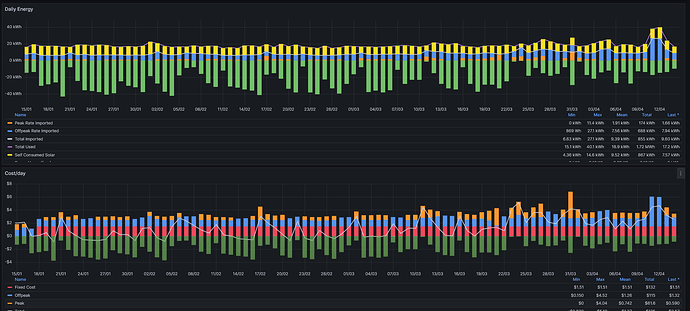

I use the InfluxDB integration and Grafana for graphing. I use includes to only store the entities I want. I keep two years worth of data. The DB is about 2.5GB.
The data will be exported whenever the entity changes state.
