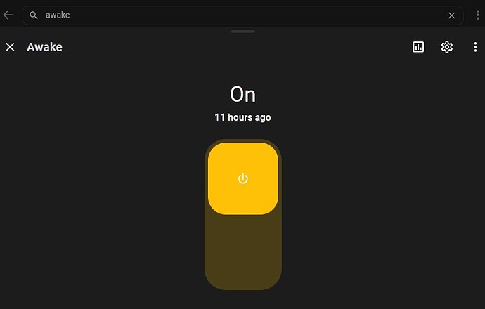

I have an input_boolean helper that I would like to expose to assist so I’m able to toggle it via voice. My problem is that it doesn’t show up in the list of entities that can be exposed. There are no settings on the helper that I can use to expose it either. How does one expose this type of item?
Open the entity for the more info pane. The look at the gear onthe top right that will show you a panel with voice assistants around mid page click voice and… Ezpose toggle
This is before and after I click settings.
There isn’t anything I can click - it’s just blank.
