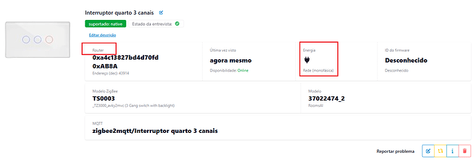

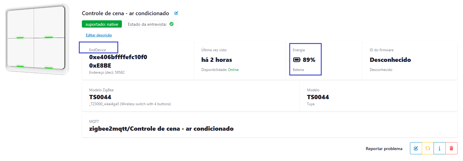

I have dozens of Zigbee devices and use Z2M to manage them.
I’m developing a custom card to display some essential information about my devices.
In the Z2M interface, I can see whether a device is a “Router” or “End Device” and whether it’s powered by the mains or battery.
I’d like to know which template functions I can use to extract this information.
Battery-powered devices have external functions that allow us to view the load, but what I’m looking for is a function that allows me to see the device’s power supply.
I’ve done a lot of research, but few have ventured into this area, and in my research, I haven’t found anyone who has had success. But the information is there, so there must be a way to extract it.
I appreciate anyone who can help.
The information is in Zigbee2MQTT.
