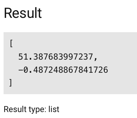

How to extract elements from a 'list'?
An integration provided entity has an attribute that Developer Tools > Template reports as being of type 'list:
How can I access the individual list items? I read the Jinja documentation and it suggests that I can just use normal array indexing syntax:
{% set mylist = state_attr('theentity','the attribute') %}
{% set item = mylist[0] %}
{{ item }}
But then I get:
which is the first character of the list rendered as a string. I’ve tried using the subscript syntax in different ways but nothing I have tried seems to work. I’ve searched for info on this but have found nothing. This stuff must be documented somewhere but I haven’t been able to find it.
Can someone explain how to do what I want to do, or better still point me to relevant documentation?

well no. When HA renders this list as a ‘string’ (for example in an entity card) the string representation is ‘(51.387683997237, -0.487248867841726)’, hence the opening parentheses.
In order to run what you asked I had to amend things as follows (add an explicit cast to ‘string’) as otherwise I get the error that ‘float’ is not subscriptable:
{% set mylist = state_attr('theentity','theattribute') | string %}
{% set item = mylist[0:5] %}
{{ item }
and then the output is:
(51.3

To clarify what is happening, first some facts: the state of any entity is always a string. An attribute of an entity can be any type. A jinja template always returns a string.
Now where it gets complicated: if you put a template in the template tester, or if you use a template to specify an attribute, then HA will try to convert the string to a number or a compound type if it can.
So from what is shown above, the template editor is saying something is a list, but from list[0] being the character ‘(’ you can tell that the template editor saw samething in a string that it could convert to a list. To illustrate, put this in the template tester. It is clearly a template returning a string (that looks like a data type known as a tuple, which is very similar to list with 2 elements):
{{ "(12, 34)" }}
The output in the right panel states this is a list, which is what HA converted the string to:
  12,
  34

@Edwin_D @petro Thanks for clarifying the (confusing) behaviour.
So, rephrasing my original question; if the entity returns a string of the format
How can I easily parse that to extract the two numeric values (as strings or floats, either is fine)? I believe that HA templates / Jinja has various string manipulation capabilities but I’m having a hard time finding any kind of comprehensive documentation on them. If this was C, or Java, or a shell script I could do it easily.
