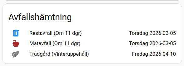

Step 3: The Dashboard Card (Bonus)
If you have a wall-mounted tablet (Kiosk mode), standard cards often take up too much space. Here is a highly compressed, dynamic card to display the data we just fetched.
Features of this card:
  • Icon colors change automatically (Grey = Winter break/inactive, Blue/Brown/Green = Normal, Orange = 3 days left, Red = 1 day left or Today).
  • Injects a dynamic countdown text right next to the name (Idag), (Imorgon), (Om X dgr), or (Vinteruppehåll).
Requirements for the card: Install template-entity-row and card-mod via HACS Frontend.
The Code:
type: entities
title: Avfallshämtning
card_mod:
  style: |
    #states > * {
      margin-top: -10px !important;
      margin-bottom: -10px !important;
entities:
  - type: custom:template-entity-row
    entity: sensor.soptomning_restavfall_datum
    icon: mdi:trash-can
      {% set datum = states('sensor.soptomning_restavfall_datum') %} {% set ts =
      as_timestamp(datum ~ ' 00:00:00', 0) %} {% set now_ts =
      as_timestamp(now().strftime('%Y-%m-%d 00:00:00'), 0) %} {% set dagar =
      ((ts - now_ts) / 86400) | round(0) | int %} {% if ts == 0 or datum in
      ['unavailable', 'unknown', 'Ej aktiv'] %} Restavfall (Ej aktiv) {% elif
      dagar <= 0 %} Restavfall (Idag) {% elif dagar == 1 %} Restavfall (Imorgon)
      {% else %} Restavfall (Om {{ dagar }} dgr) {% endif %}
    state: >
      {{ states('sensor.soptomning_restavfall_veckodag') }} {{
      states('sensor.soptomning_restavfall_datum') }}
    color: >
      ['unavailable', 'unknown', 'Ej aktiv'] %} grey {% elif dagar <= 0 %} red
      {% elif dagar <= 3 %} orange {% else %} dodgerblue {% endif %}
    entity: sensor.soptomning_matavfall_datum
    icon: mdi:food-apple
      {% set datum = states('sensor.soptomning_matavfall_datum') %} {% set ts =
      ['unavailable', 'unknown', 'Ej aktiv'] %} Matavfall (Ej aktiv) {% elif
      dagar <= 0 %} Matavfall (Idag) {% elif dagar == 1 %} Matavfall (Imorgon)
      {% else %} Matavfall (Om {{ dagar }} dgr) {% endif %}
    state: >
      {{ states('sensor.soptomning_matavfall_veckodag') }} {{
      states('sensor.soptomning_matavfall_datum') }}
    color: >
      {% elif dagar <= 3 %} orange {% else %} brown {% endif %}
    entity: sensor.soptomning_tradgard_datum
    icon: mdi:leaf
      {% set datum = states('sensor.soptomning_tradgard_datum') %} {% set ts =
      ['unavailable', 'unknown', 'Ej säsong'] %} Trädgård (Ej säsong) {% elif
      dagar > 30 %} Trädgård (Vinteruppehåll) {% elif dagar <= 0 %} Trädgård
      (Idag) {% elif dagar == 1 %} Trädgård (Imorgon) {% else %} Trädgård (Om {{
    state: >
      {% set datum = states('sensor.soptomning_tradgard_datum') %} {% if datum
      in ['unavailable', 'unknown', 'Ej säsong'] %}
      {% else %}
        {{ states('sensor.soptomning_tradgard_veckodag') }} {{ datum }}
      {% endif %}
    color: >
      ['unavailable', 'unknown', 'Ej säsong'] or dagar > 30 %} grey {% elif
      dagar <= 0 %} red {% elif dagar <= 3 %} orange {% else %} #4CAF50 {% endif
view_layout:
  position: sidebar
Hope this helps anyone who need a garbage collect card in Stockholm out! Let me know if you have any questions.

It seems SVOA changed the API, now this should work:
- resource: "https://www.stockholmvattenochavfall.se/villa-och-radhus/avfallstjanster/nar-kommer-sopbilen/Search?address=xxxxxxxxxxxxxxxxxxx"
  scan_interval: 7200
  headers:
    User-Agent: "Mozilla/5.0"
    Accept: "application/json"
  sensor:
    # 1. RESTAVFALL och MATAVFALL
    - name: "Soptömning Restavfall Datum"
      unique_id: soptomning_restavfall_datum
      icon: mdi:trash-can
      value_template: >
        {% set ns = namespace(val='Ej aktiv') %}
        {% for item in value_json %}
          {% if 'restavfall' in item.group %}
            {% set ns.val = item.executionDate %}
          {% endif %}
        {% endfor %}
        {{ ns.val }}
    - name: "Soptömning Restavfall Frekvens"
      unique_id: soptomning_restavfall_frekvens
      icon: mdi:update
      value_template: >
        {% set ns = namespace(val='Okänd') %}
            {% set ns.val = item.fetchFrequency %}
          {% endif %}
        {% endfor %}
        {{ ns.val }}
    - name: "Soptömning Restavfall Veckodag"
      unique_id: soptomning_restavfall_veckodag
      icon: mdi:calendar-today
      value_template: >
            {% set ns.val = item.weekday %}
          {% endif %}
        {% endfor %}
        {{ ns.val }}
    # 2. PAPPER och PLAST
    - name: "Soptömning Papper och Plast Datum"
      unique_id: soptomning_papper_datum
      icon: mdi:package-variant-closed
      value_template: >
          {% if 'papper' in item.group %}
          {% endif %}
        {% endfor %}
        {{ ns.val }}
    - name: "Soptömning Papper och Plast Frekvens"
      unique_id: soptomning_papper_frekvens
      icon: mdi:update
      value_template: >
          {% endif %}
        {% endfor %}
        {{ ns.val }}
    - name: "Soptömning Papper och Plast Veckodag"
      unique_id: soptomning_papper_veckodag
      value_template: >
          {% endif %}
        {% endfor %}
        {{ ns.val }}
    # 3. GLAS och METALL
    - name: "Soptömning Glas och Metall Datum"
      unique_id: soptomning_glas_datum
      icon: mdi:glass-fragile
      value_template: >
        {% set ns = namespace(val='Ej säsong') %}
          {% if 'glas' in item.group %}
          {% endif %}
        {% endfor %}
        {{ ns.val }}
    - name: "Soptömning Glas och Metall Frekvens"
      unique_id: soptomning_glas_frekvens
      icon: mdi:update
      value_template: >
          {% endif %}
        {% endfor %}
        {{ ns.val }}
    - name: "Soptömning Glas och Metall Veckodag"
      unique_id: soptomning_glas_veckodag
      value_template: >
          {% endif %}
        {% endfor %}
        {{ ns.val }}
    # 4. TRÄDGÅRDSAVFALL
    - name: "Soptömning Trädgård Datum"
      unique_id: soptomning_tradgard_datum
      icon: mdi:leaf
      value_template: >
          {% if 'Trädgård' in item.group %}
          {% endif %}
        {% endfor %}
        {{ ns.val }}
    - name: "Soptömning Trädgård Frekvens"
      unique_id: soptomning_tradgard_frekvens
      icon: mdi:update
      value_template: >
          {% endif %}
        {% endfor %}
        {{ ns.val }}
    - name: "Soptömning Trädgård Veckodag"
      unique_id: soptomning_tradgard_veckodag
      value_template: >
          {% endif %}
        {% endfor %}
        {{ ns.val }}
