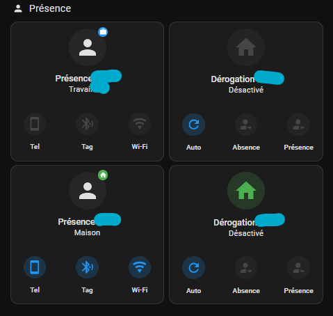

I have a slightly more complex presence calculation based on three factors:
  • The companion app
  • The phone’s Wi-Fi presence
  • Detection of the bluetooth tag on the keys
These three elements are taken into account to determine whether a person is theoretically present or not.
In addition, for each person, there is an “actual” presence template. This template takes into account the theoretical presence, as well as whether two Boolean values are set:
  • Forced presence
  • Forced absence
A Boolean variable groups together all “actual presence” Booleans. It determines whether the “at home” status is active or not (alarm, specific automation, etc.).
99.99% of the time, the theoretical presence works just fine. But if someone has left their phone at home and/or their keys (the kids don’t have phones) or at the office, I set the appropriate Boolean sensor.
Visually, this is how it appears on my dashboard :
In short, I think the key lies in combining detection methods to avoid false positives and false negatives.
