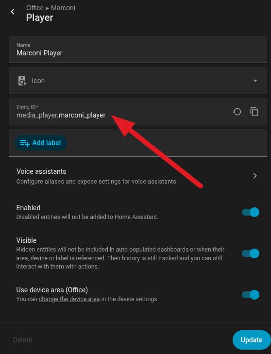

actually this already exists apparently, although it’s not apparent.
2026.3 :
device : delete the contents of the device name field
entity : delete the contents of the entity name field
2026.4 :
entity : click the "reset button"
