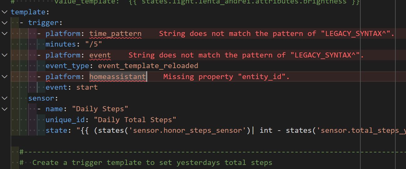

Thanks for the advice. I added this code to my configuration.yaml but got a bunch of errors((
