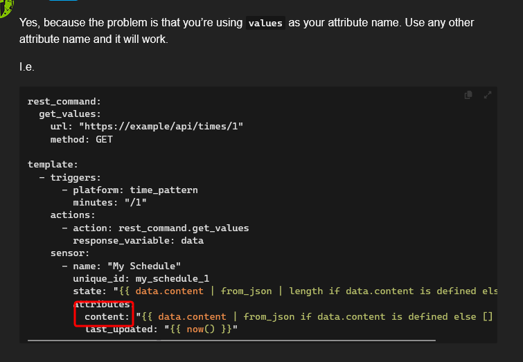

Yes, because the problem is that you’re using values as your attribute name. Use any other attribute name and it will work.
I.e.
rest_command:
  get_values:
    url: "https://example/api/times/1"
    method: GET
template:
  - triggers:
      - platform: time_pattern
        minutes: "/1"
    actions:
      - action: rest_command.get_values
        response_variable: data
    sensor:
      - name: "My Schedule"
        unique_id: my_schedule_1
        state: "{{ data.content | from_json | length if data.content is defined else 0 }}"
        attributes:
          content: "{{ data.content | from_json if data.content is defined else [] }}"
          last_updated: "{{ now() }}"
