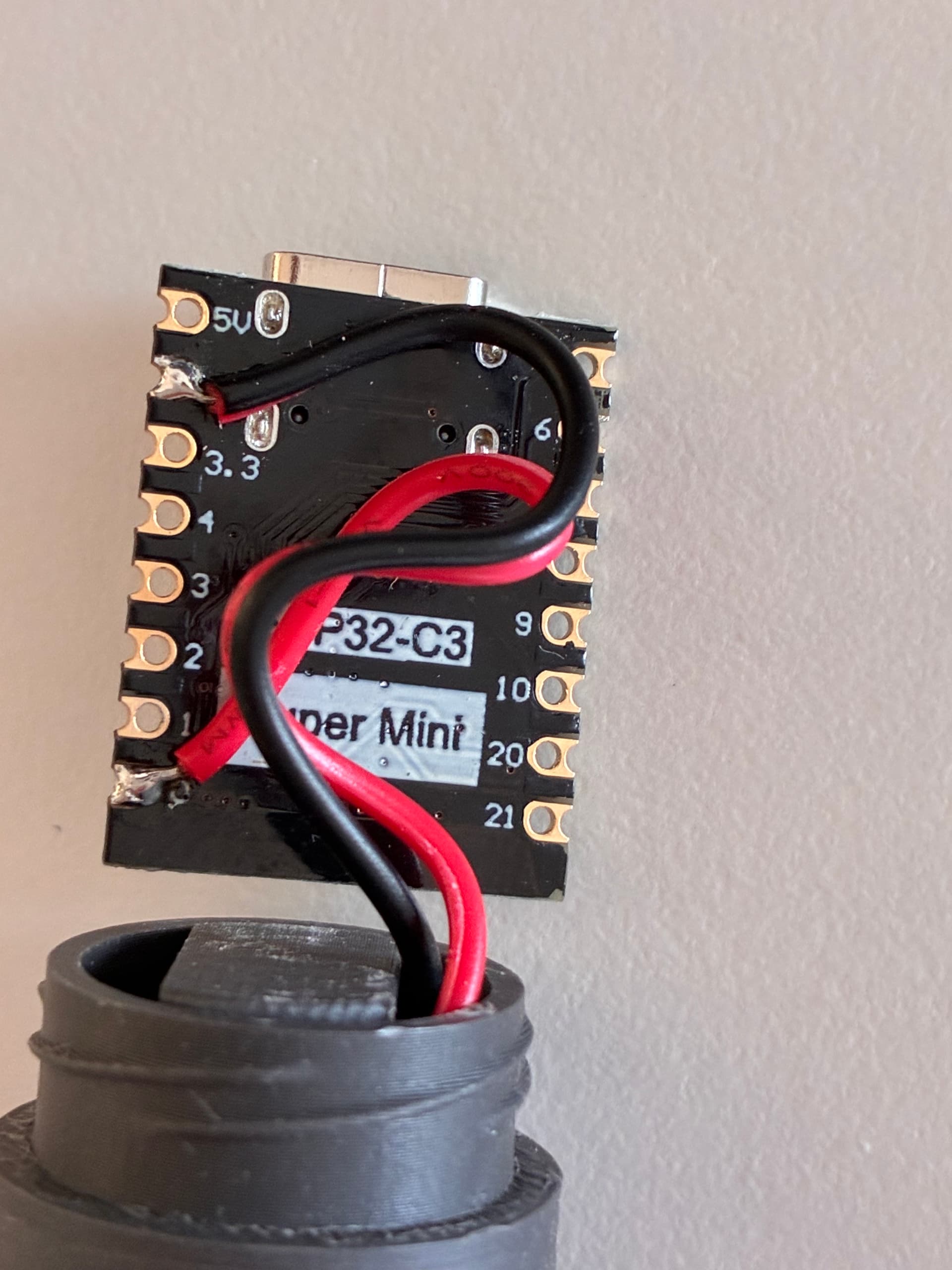

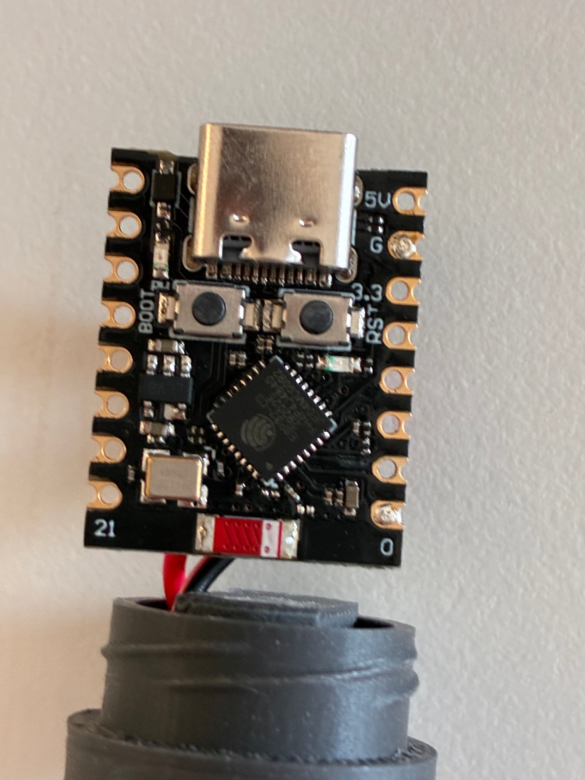

Unlikely to be correct. GPIO0 is typically wired to the boot switch on an ESP32.
Can you tell from the pics?
Ah C3. Nevermind, it’s correct then.
