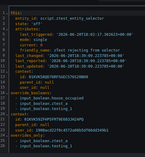

It creates a new variable, overrides_only, that selects just the entity IDs from the input list that match the search criteria. Here's a screenshot of the "changed variables" section from the trace from a simple script, you can see the two lists:
I was using "test_|testing_" in my search.
