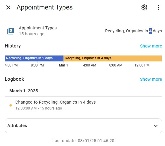

Then if click on Appointment Types sensor, see below:
How can I extract the days and types in a separate array/temporary sensors such as “Recycling”, “Organics” and “4” from the data provided by the Appointment Types sensor?

Is it always a string with numbers, or is it something else, for instance on collection day?
Anyways, a template sensor helper using a template like this would pull out the numbers. You need to set the unit_of_measurement to days in order for it to be a proper number.
{{ states('sensor.mywastesensor') | regex_replace('[^\d]', '') | int(0) }}
