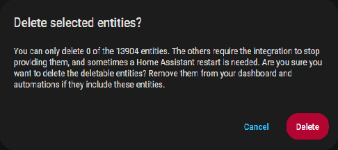

Made an AWFUL mistake today. Under some stupid whimsy decided to add another Remote Home Assistant custom integration :frowning: One was working flawlessly between my 2 HA instances in different locations sending data in one direction from slave to master for some years already- very convinient. But my stupid idea to make traffic in both directions resulted in ā€œmirrorā€ effect despite my idea that different prefixes would block such behavior - and result was a massive amount of sensors like c2_c2_c2… (some thousands of them)- and despite uninstalling Remote Home Assistant after numerous attempts to delete them on both instances had to give up. Any ideas- the only way I see now is to delete them permanently from core entities registry and database- but how?

Thanks for the suggestion but that is just this that does not work for me :frowning:
This is the mess I managed to create :frowning:

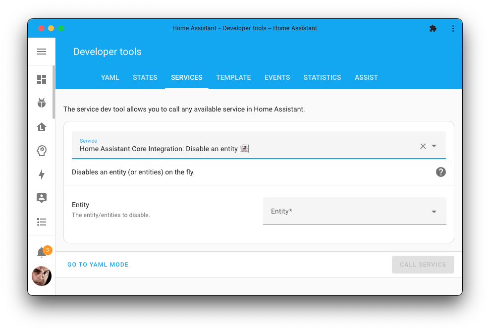

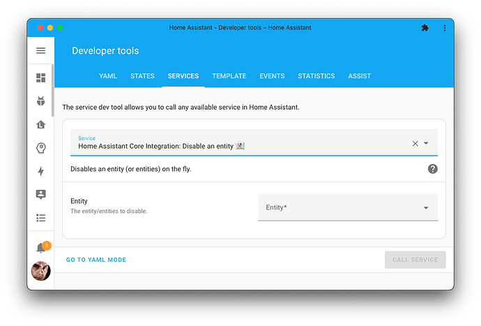

I think the spook integration can remove the entities if they are marked as orphaned.
Wow, that name is diabolical.
