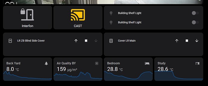

Hi all. Have been using HA for a few years now and wanted to give sections a try. Had everything lined up except for two cover cards that do not want to align. Can anybody chime in? Thanks!
Another SC:
If it’s not an empty Heading card in that gap (which looks perfectly space), you could toss both cover cards inside a horizontal stack card
Yeah my bet is an empty heading card too.
Thanks a lot, this did the trick. I did not have an empty Heading though.
odd for sure. but glad its looking better now inside a horizontal stack :slight_smile:
I would say one of the cards above requires more rows than are defined in the layout settings of the card. Your Interfon and CAST cards are aligned, but the Building Shelf Light card to the right of those has a slightly greater overall height.
Setting those cards’ layout to rows: auto may resolve the issue without the need for the horizontal stack.
Ah yes, this too. Good call. Check your Layout tabs of the cards above.
