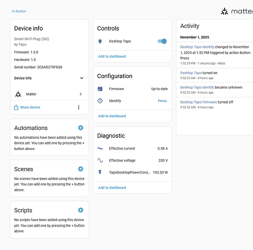

I have connected the plug through Matter and I can see the current consumption through diagnostics, but its not possible to add to my Energy overview. That was only possible when I added it through hacs with a custom integration without Matter.
Maybe you have to reinterview the device?
For me it shows “voltage”, “current”, “exported energy”, “energy” and “power”.
